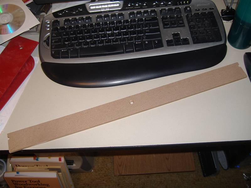

This photo shows a 520 insert made out of "Masonite" material which I can not find anymore and as you will see in the next picture it looks a lot like the MDF material shown there.
[ATTACH]7621[/ATTACH]

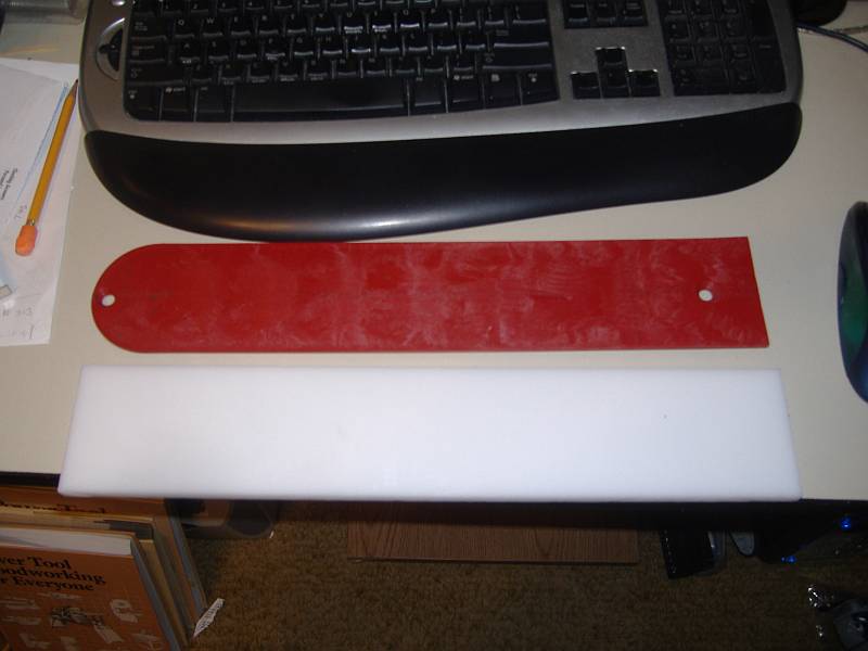

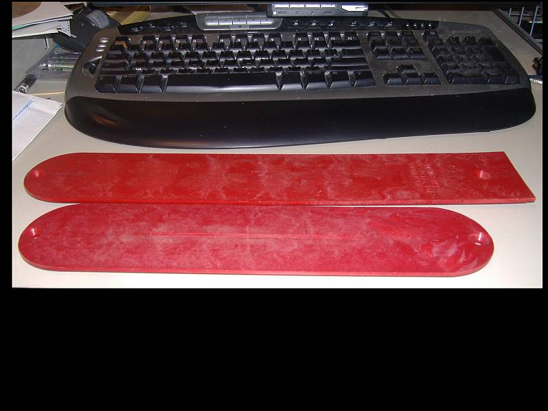

What you see here is an shopsmith blank insert and a UHMW plastic "blank" cut to size. We are going to take the blank an make it into something called a zci.
[ATTACH]7624[/ATTACH]

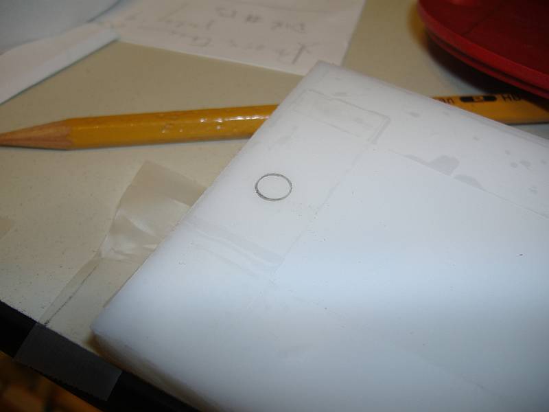

Since I'm working on a plastic that it hard to mark on you will see me using a invisible tape on the plastic so I can see my marks, you don't need to do that if you are working on a material that you can easily mark. Actually you may not see the tape, after all it is invisible.
Now we are going to use our caliper fingers to get things started. Your fingers if they are working properly can detect differences less the .001" so what you are now going to do is center real insert over our blank. Centered as in both width and length. If you use the metal insert out of your table it might be best as it will be accurate so far as distance between the mounting holes.
You might want use some double sided tape or just tape the parts together with making tape or use c-clamps. What ever it takes to keep them from moving while you are caring out the next process. You could put them in a vice or even use tight rubber bands to control them.
Now will come the time I will discuss several next steps for the marking of where the holes are going to be. The least accurate way but still an option is to take a pencil and trace around the inside of the hole. You need to keep the pencil vertical and depending on how good you do will be seen in how well the holes line up with the saw table. I think most people will be close enough doing it this way but there are better ways which I will also cover. After drawing the circle you can either eye ball the center point or use what ever method seems best to locate the center point.

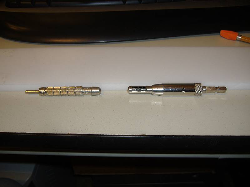

Some other options might be a center punch used for doing hinges etc or maybe a LARGE size hinge drill bit. My largest hinge bit is too small but I know there are larger ones to be had.
[ATTACH]7632[/ATTACH]

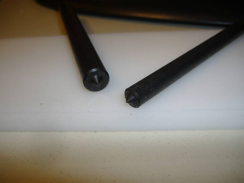

What might be the best way to do this is with what are called transfer punches. I have a set of them and this is how I most often get my hole where they should be. Works will for marking gaskets, wood, and what have you. The ones I have are fractional and range from memory about 3/32" to 1/2" by 1/64" steps. They are just undersized by like .002" or so they can be used without sticking in holes. When I get this post about done I go get one to post a picture of it... if I remember.
If you have a set of transfer punches use them, and since you have them you will no doubt already know how to do that.

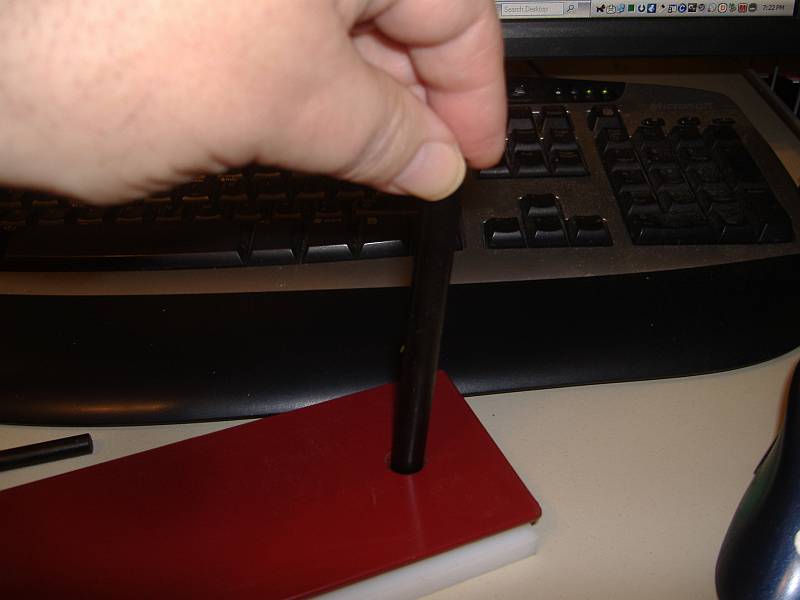

The two holes on the 5++ inserts are not the same size. So to do use the transfer punches you need a 27/64" one for the squared end and a 5/16" for the front end where it is rounded.
[ATTACH]7634[/ATTACH]
[ATTACH]7635[/ATTACH]

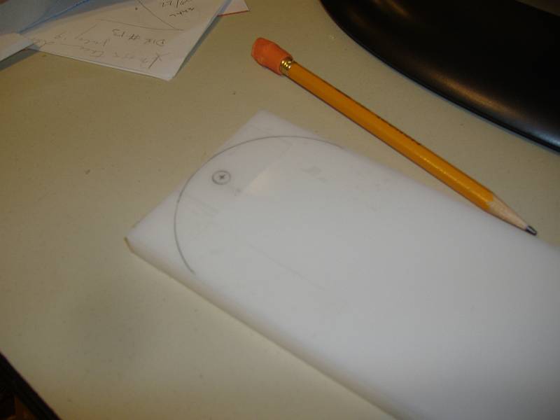

With the hole in place it is now time to do the rounding of the end(s). Again you will want to use the holes to align both the sample part and the new insert you are building. Once they are lined up it is time to draw the radius.
(Note that my shop is closed for the season so the pictures you will see will not have the hole in place.)
[ATTACH]7636[/ATTACH]
Now comes a breve of options as to how to make the end round. There are more then I care to list but I'll point out at least a few of them.

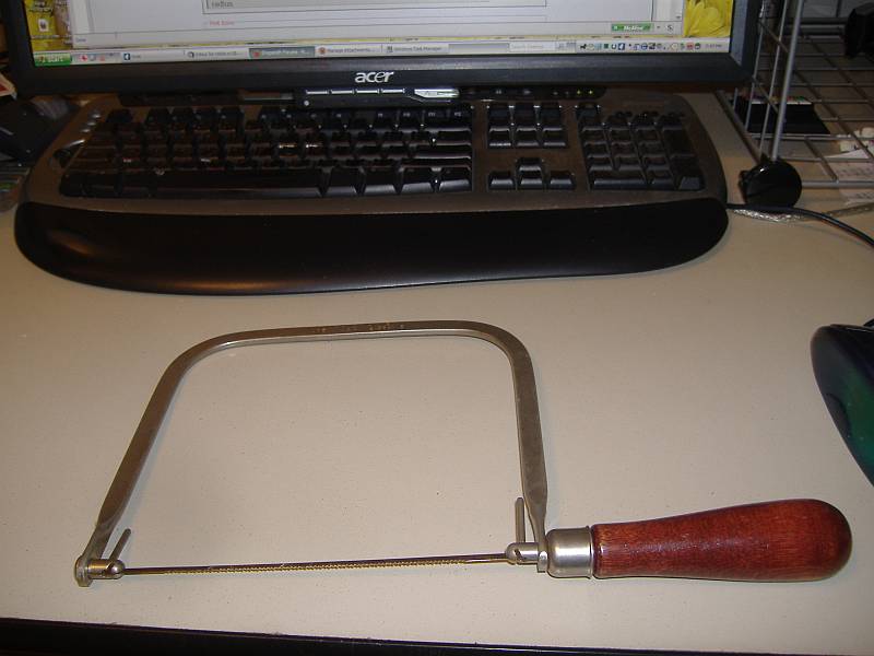

The use of a hand tool such as the coping saw would work. You may like to clean up the cut with some sandpaper after but then again it is only an insert so some may not care to. This is the saw to which I was referring:
[ATTACH]7637[/ATTACH]

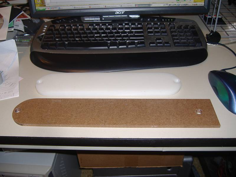

The end product should be something like these:
[ATTACH]7638[/ATTACH]
