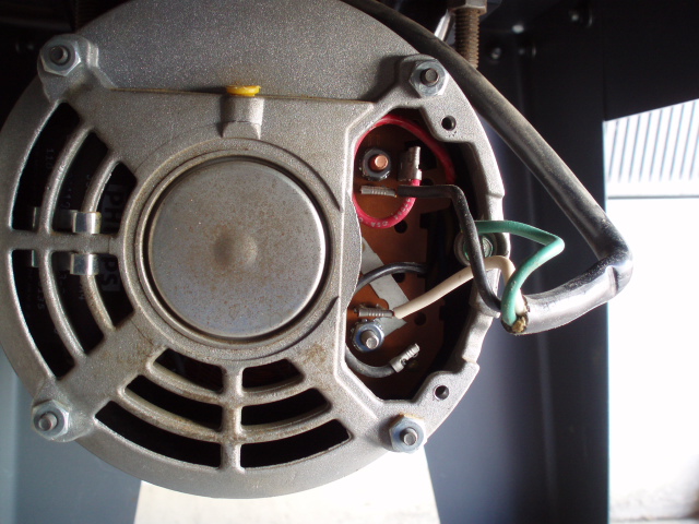

It has been pointed out that the motor has been dropped. That being done, I would make the repair by replacing the entire white wire. Inside the access cover there is a connector block where this broken wire attached to the motor.
[ATTACH]7800[/ATTACH]
This is NOT the Mark V motor but there is a similar connector panel in the Mark V motor.
BTW - notice the yellow plug on the end of the motor. Where ever one of these exists, on the inside there are bearings that just beg to be oiled now and then. This is the motor on my Crafter's Station. A similar motor exists on the Power Station.
There is an identical oil port on the other end of the motor.

dusty wrote: That being done, I would make the repair by replacing the entire white wire.
That makes about as much logic as replacing a new bride because she got nervous and burned the first meal...
Do you always over-react to minor electrical problems like that?
Cut and re-strip the end of the wire, crimp on a new terminal and move on. That is what Meangreen has done. You will note that he said it is now throwing sawdust all over the place.
The wire was not defective, it was physically damaged at the crimp. The rest of that wire should be still as good as any other wire in the machine.

Ok all I have some great news. My SS is up and throwing saw dust all over. I talked with SS CS this morning and let them know what the issue was and asked if I could repair it or would I have to send it back to them. I was given the go ahead and after all repairs were made I contacted SS to let them know the status. SS CS was happy enough to give me a SS gift card.
So know I am almost happy as a lark. I started some lathe work and one of the knives came out of the handle and landed on my foot (Ouch). I guess I'll be sending that one back on monday.
Again thanks for all the help and advice.
