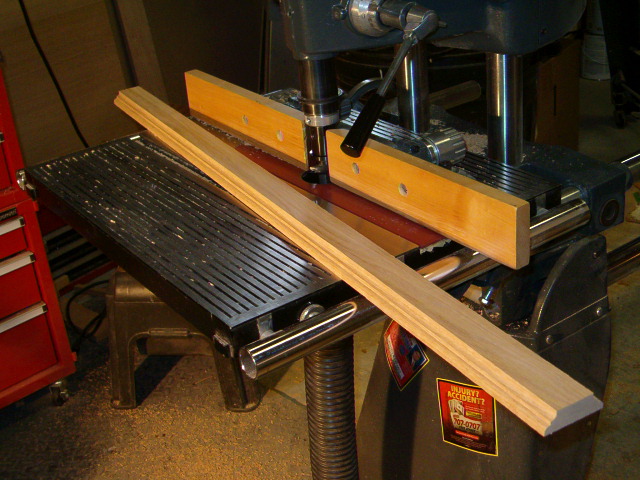

Here's the set-up and the results of using the shaper to make bottom molding. Just need to rip off the two edges. Actually I had first tried the router with a couple of bits. Frankly, I liked using the shaper more than the router in a table. The shaper was smooth. Just had to move the wood slowly. There was no danger of burning. The set-up was quick and easy. I'll have to use this tool more often.

charlese wrote:Here's the set-up and the results of using the shaper to make bottom molding. Just need to rip off the two edges. Actually I had first tried the router with a couple of bits. Frankly, I liked using the shaper more than the router in a table. The shaper was smooth. Just had to move the wood slowly. There was no danger of burning. The set-up was quick and easy. I'll have to use this tool more often.
I have been telling people that for years.
Especially every time somebody that has never tried it jumps in and says that it won't work...
Now if I could just convince guys that you don't have to feed wood at a run when you are not running factory production...

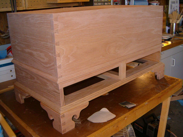

Wow! This molding was trouble! When ripping the molding from the board (Post #26) I sawed the molding too thin, un-usable. Shaped another shape on the (now) flat side of the board, and ripped both sides properly.
Here's where I really screwed up - sawed off the miter on the wrong side of the line.

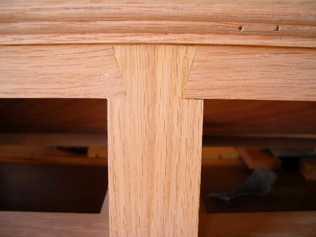

This rendered one of the two sides again unusable. Finally, made up a new piece and got the lower molding glued in place, but not until I made up a dovetailed drawer divider. Don't know why I bothered to dovetail the bottom of the divider. It is covered with the molding!:(
Then attached the feet with screws and glue. I set the feet 1/8" proud of the molding. Could have made it flush with the molding, but thought a little step looks better.
Here's the chest as it sits today, and a close up of the drawer divider. The brad holes under the upper molding have yet to be filled.
The first photo shows 'wrap around grain' at the front left corner of the chest. This is my first try to get this effect, Wonder if it will be noticeable when finished? I couldn't keep the other corners organized to get the effect. In fact, one of the sides was dovetailed backwards.
