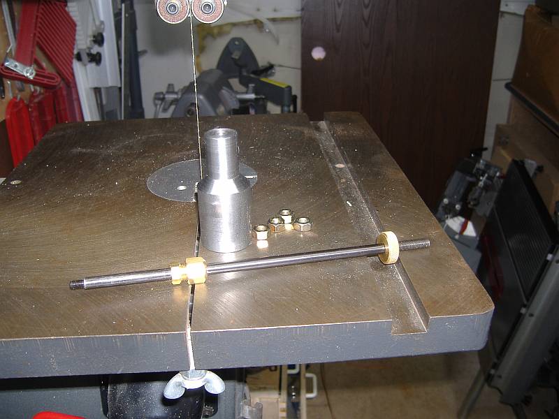

I got the parts in a while back but it has been a bit to cold to do much with them until today.
I thought I would share some pictures of what I've collected and them see if I can get any additional help on what else I will be needing to make use of these items.
Pictured here is a 1/4" router bit adapter (I don't know if this is an old shopsmith item or a ???? from some other source, anyway it doesn't look like the current one and uses odd size setscrews and has only one setscrew where the router bit would mount???). Then the items I got from the Woodcraft catalog. The compressing stop nut seems to have a lot of holding power, one of the things I was wondering about. The knurled brass nut looks like it would work but I picked up a few nuts that fit with less height.
[ATTACH]8050[/ATTACH]

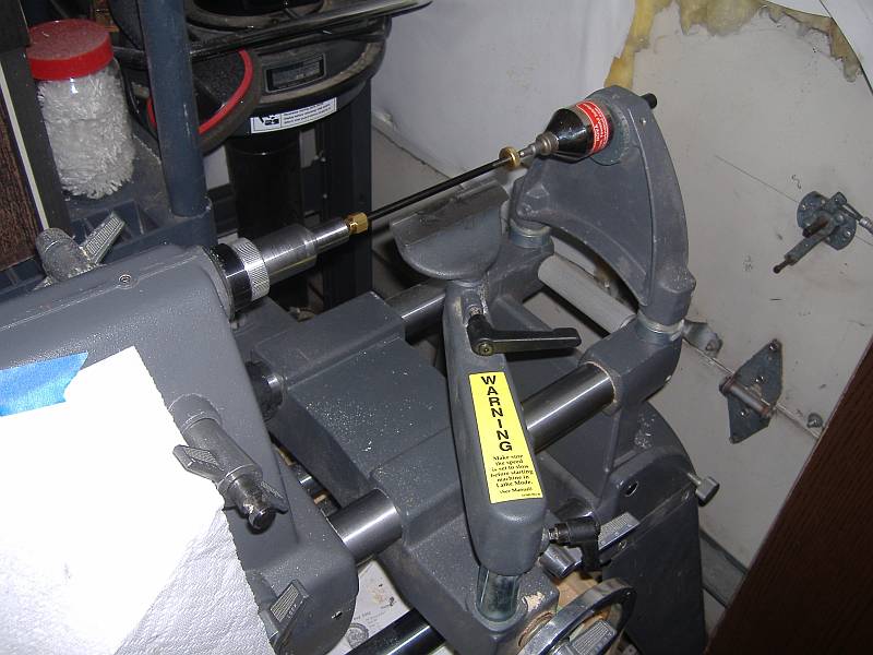

Next I stuck it together on the shopsmith. I mounted my Nova live center with the small 60 deg point for the end stock. The rest is just as shown.
[ATTACH]8051[/ATTACH]
When it warms a bit more in the garage I was thinking of turning a couple of lamp pulls to give it a try... then maybe if I get some extra $ get a pen set to try. So other then the lathe tools is there anything else I should be shopping for??
