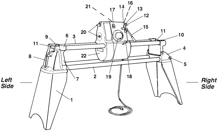

marteen wrote:Please forgive the additional questions for I am just a newbee to the world of SS.
How exactly is the 30w oil applied to the headstock? Is the front cover off the headstock the only thing that needs to be removed before applying the 30w? Do I just pour the oil in or strategically apply to certain areas?
Also is it required to take the top cover off? I ask because I watched the Maintenance and Cleaning video with Nick and it looked pretty involved. Also, he treated parts with an aerosol spray outdoor lacquer and the inside of the motor housing with navel jelly and spray lacquer. Is this another method for rust prevention?
Maybe we're confusing some of the terminology, but there's not a "front" or "top" cover. Review this image so we're all on the same page with left, right, front, and back.
[ATTACH]8419[/ATTACH]
So, "right" is the side where the saw blade, drill chuck, etc. goes. "Left" is the side with two spindles for attaching the jointer, bandsaw, and other SPTs. "Front" is the side with the speed changer and power switch. And on the "back" side is a logo plate. Except for a few of the older Shopsmiths, this can be removed to reveal an access hole. That gives you access to the "control sheave" - that's the pulley half that is attached to the speed control. On the shaft of that sheave is a small hole. You should apply a couple drops of oil in that hole so that the control sheave can move freely.
Then, if you remove the belt cover (#22 in the above diagram) on the left side of the headstock, you can see the "floating sheave" that is attached to the motor shaft. Just as with the control sheave, this sheave moves on a shaft as the speed changes. And, just as with the control sheave, there is a small hole for oiling that shaft so it moves freely.
The Sawdust Session linked to below covers the lubrication and maintenance. It's really not as difficult as it might appear to be.
http://www.shopsmithacademy.com/SS_Arch ... enance.htm
Maybe someone a little more experienced than I am can chime in and fill in any details I might have left out.
