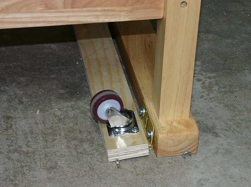

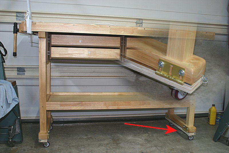

Here's the idea I came up to make my workbench portable using inexpensive casters where the design allows them to be tucked away when not in use.mickyd wrote:Great economy workbench for $125 + Arnold's 8.75% share.....
To make the bench portable, I had an idea on how to mount some swivel casters that will neatly tuck away when not in use. I'll post pics when / if the concept works. Much simpler and attractive than the ones shown in post 59.
UPDATE 7-01-10 The plywood needs to be wider so that the centerline of the caster axel is OUTSIDE the side of the leg. Here's the redesign. That eliminates the need for the eye hook and clasp shown.
Casters are mounted on a strip of plywood which is hinged to the bench leg. You'll notice that the hinge mounting holes have been elongated / slotted. I’ll explain later.
[ATTACH]8433[/ATTACH]
The bench weighs about 150 lbs which makes it relatively easy to manually lift one end of the bench and with your foot, flip the casters inward which puts the bench back down on its original legs. If you didn’t want to manually lift it, you could also some kind of pry under the leg.

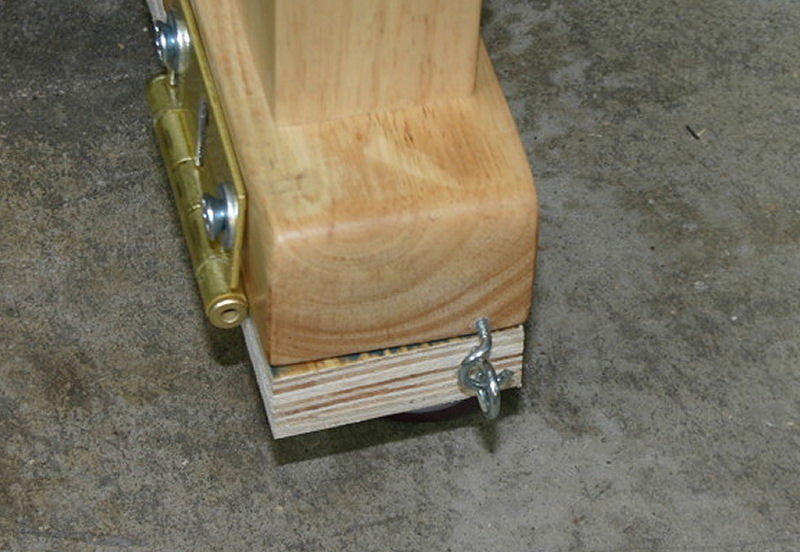

I had to add a little eye hook latch to keep the casters in their raised position when moving it around. The set up tended to fold under if I rolled it around too fast. This design flaw could be avoided by making the mounting plywood a couple inches wider and setting the casters out past the end of the leg a tad.

Now the reason for slotting the hinge holes as shown in the first picture. They’re slotted because with the casters in the down position, the hinge pin extends BELOW the bottom of the bench leg as you can see in the first picture. When the casters are folded to the inside, you don’t want the bench to rest on the hinge. By keeping the hinge mounting screws loose and having the holes elongated, the hinge raises up and the bench sits on its feet properly as shown in the second picture.
