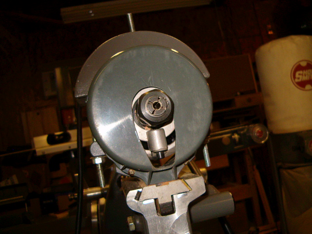

I drive a Porter Cable 890, 2-1/4 HP Router. I really like it for the OPR because of the power switch at the top of the motor. With a little modification of the "Dust Shield/Deflector" or the OPR, you can change bits with one wrench, by depressing the locking button while still mounted. (Photo below) When mounted, the power cord comes out at the front, but this is not a problem as the cord is then hung over the protruding parts of the headstock.
For a little lighter duty, the Porter Cable 690 is a 1-3/4 HP (11 amp) variable speed router for less $. Many folks like it.
[ATTACH]8464[/ATTACH]

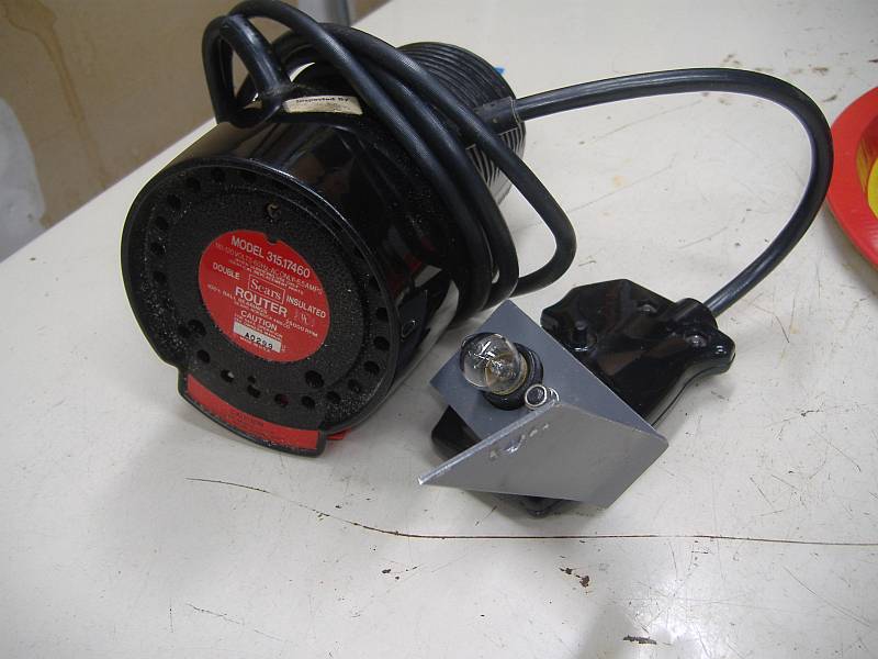

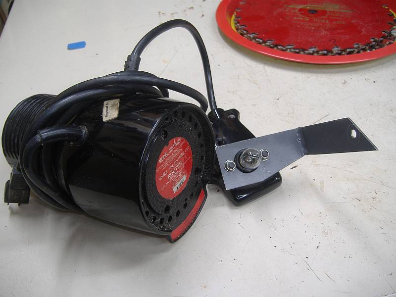

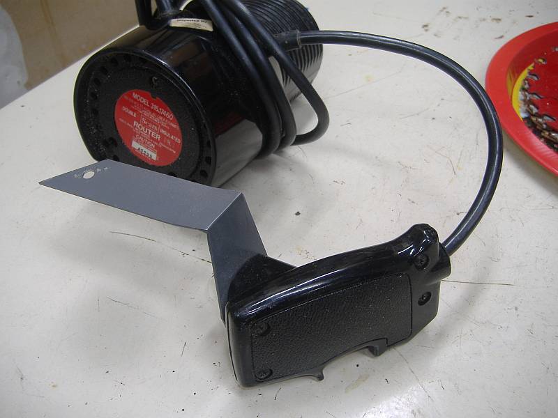

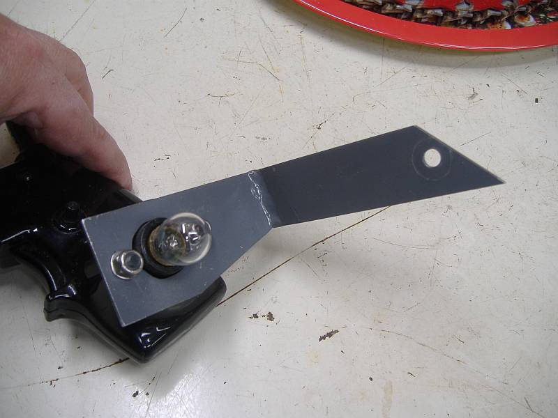

Hi,
You didn't mention which Craftsman router you have but here is an example of how the previous owner of my old style OPR had set up to use his:
[ATTACH]8481[/ATTACH]
[ATTACH]8482[/ATTACH]
[ATTACH]8483[/ATTACH]
[ATTACH]8484[/ATTACH]
