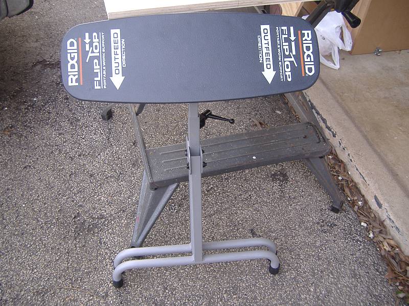

To start with here is a picture of it in storage position.
[ATTACH]8544[/ATTACH]

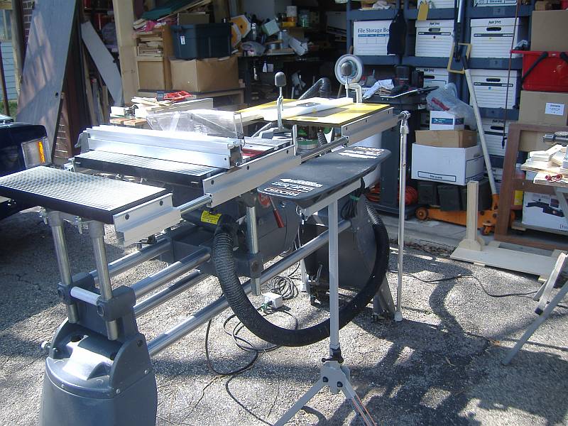

You can of course use these many different ways but I have already found I like to put it in the horizontal locked position just behind the shopsmith main table for working on shorter stock. This is what that looks like:
[ATTACH]8545[/ATTACH]

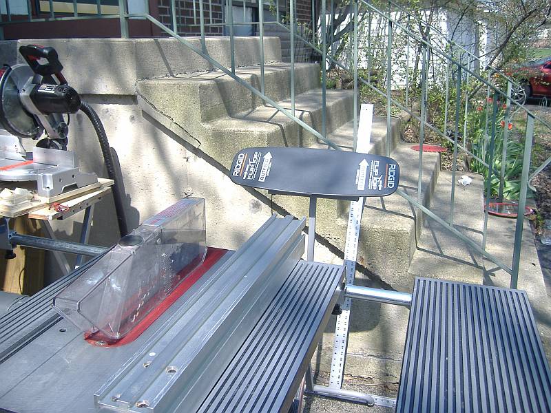

The part that I really like is when you unpin the top and let it go in flip position. As you know it is not on common for the stock to sag after it leaves the shopsmith table. If you want to use a support stand to support the work piece then this sag can be a real problem. I have even had the stock knock over the support stand rather then roll up on it. Not such a fun position to be in.
The next set of pictures show how the stand manages to keep you working away without the hassle of some of the other stands on the market. (Please note that no woodworking is happening in these pictures they are of illustrations only.)

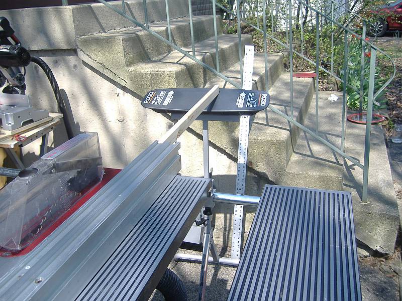

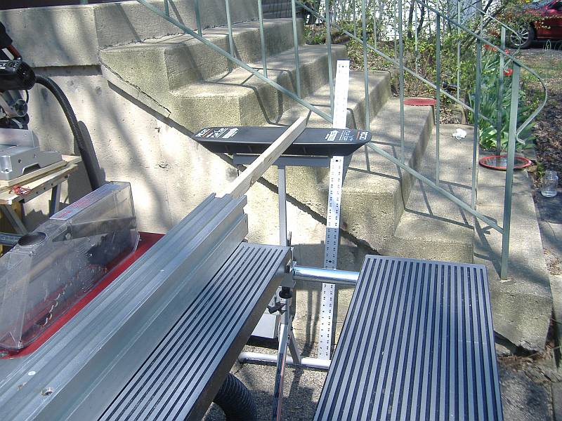

[ATTACH]8546[/ATTACH]
[ATTACH]8547[/ATTACH]
[ATTACH]8548[/ATTACH]
