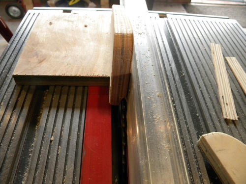

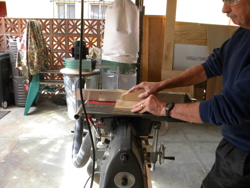

Actually a "regular" shoe will cut infinitely close to the fence which wouldn't be a great idea with the SS fence stradler. A shop made Q&D shoe is a consumable not a tool . Obviously you size the shoe based on how high above the material you let your blade emerge (another thread) so as to be confident that your pinkies are safe. The strips on the right of the fence were just cut and are less than 1/8" thick.
[ATTACH]8578[/ATTACH]
[ATTACH]8579[/ATTACH]
Paul M (alias the shoe guy)

shipwright wrote:Actually a "regular" shoe will cut infinitely close to the fence which wouldn't be a great idea with the SS fence stradler. A shop made Q&D shoe is a consumable not a tool . Obviously you size the shoe based on how high above the material you let your blade emerge (another thread) so as to be confident that your pinkies are safe. The strips on the right of the fence were just cut and are less than 1/8" thick.
thank you for the correction. you are right.
