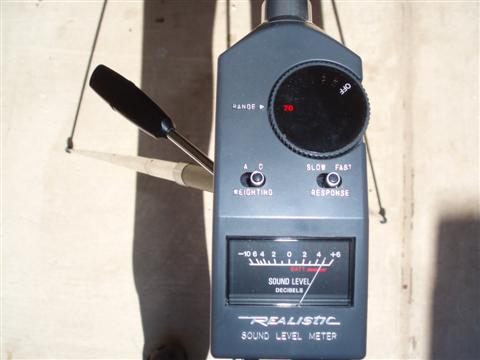

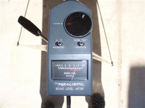

Noise Level Base Line Readings
When I finally do this pending rebuild it will be interesting to see what the noise level differences are. Right now, without doing anything to the Mark V, the noise readings would meet the acceptance criteria established in this thread.
[ATTACH]8759[/ATTACH] [ATTACH]8760[/ATTACH]
Low Speed on the left (70dB Range) and High Speed on the right (80 dB range)
My machine generates a little bit more noise at high speed than Jacob Anderson says is acceptable at low speed BUT my readings are with a 5 foot separation between the headstock and the noise meter. It Jacob's DVD he is holding the noise meter much nearer the headstock and the headstock is setting on a padded bench top.
If noise level was the only factor, I probably should not bother with changing bearings throughout.
Low Speed at 5 feet (Custom).JPG (28.95 KiB) Viewed 3844 times
High Speed at 5 feet (Custom).JPG (26.99 KiB) Viewed 3839 times

I noticed you were NOT using the A weighting as recommended by 8iowa. Does it make a difference in the readings?
JPG40504 wrote:I noticed you were NOT using the A weighting as recommended by 8iowa. Does it make a difference in the readings?
Using A-weighting rather than C-weighting would certainly provide some variations in the readings.
When using A-weighting, this meter responds to a frequency range from 500 Hz to 10,000 Hz. This is basically the entire range of human hearing.
The C-weighting response curve is from 32 Hz to 8,000 Hz and is nearly uniform over the entire range. This provides a good indication of overall sound levels.
Is one mode more appropriate than the other for this specific test purpose? I don't know.
The manual states: "Use A-weighting for voice recordings, or C-weighting for full range musical material". The sweet sound of a smooth running Mark V is truly "music to my ears", and no one was talking during this test so I used C-weighting.
If anyone needs to know what the readings would be in a different set up those results can be had. Just ask.
