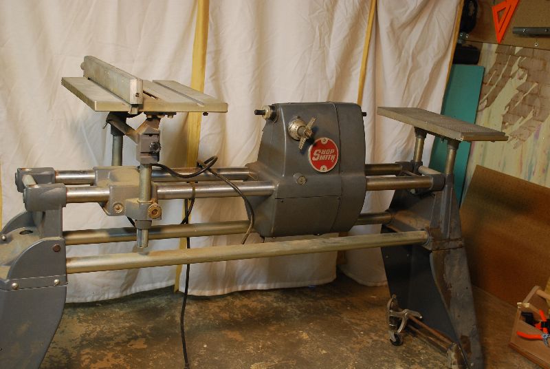

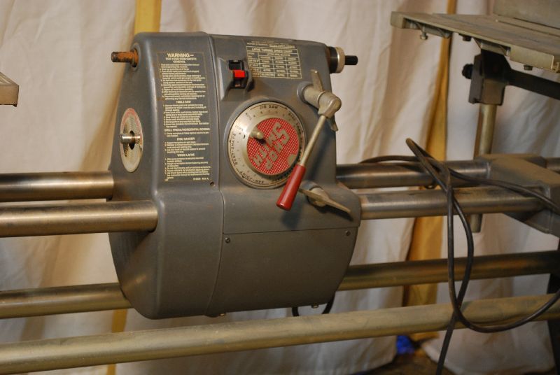

I have been looking for another Mark V to use as my main machine so I can turn my first one into a mini or shorty. Last weekend I found it! I bought a Mark V 500 and a bandsaw on a power station, and it also came with a 510 table upgrade. It was an ebay auction, so I figured I was taking a chance on the condition. I intended to completely tear down the new machine to make it shine, but as I got into it, I realized that it was almost like new! Also, the 510 upgrade seems to be complete and appears to have never been on the machine. I think it was used only as a table saw, then sat for a long time. I tore the headstock down most of the way to get everything cleaned up, lubed and waxed and now have it back together. Here are some pics of the Mark V.
I think this is a "C" headstock
[ATTACH]8772[/ATTACH]
Back side with newer access plate. My old one has spring clips. I think I like the old style better, because I would constantly bump the new one and it would fall down...
[ATTACH]8773[/ATTACH]
I think that rusty spot is where the serial number sticker is supposed to be :mad: Does anyone have an idea of the age of this machine?

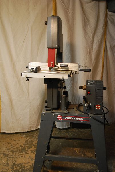

Here are the new bandsaw and power station. I had just finished restoring my old bandsaw, but this one came with the table upgrade and fence. I figure I can mix and match parts to make one. I'm not sure yet if I want to keep both bandsaws. I also don't know if I am going to keep the power station. I had told my wife that I didn't really need it and could recoup some of my costs. We will see how that goes. :D
Power Station
[ATTACH]8776[/ATTACH]
Bandsaw
[ATTACH]8777[/ATTACH]

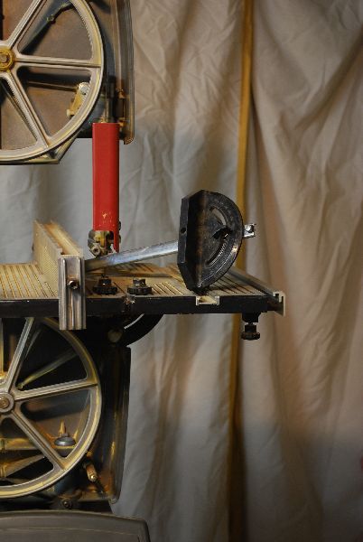

Does anyone know if the miter gauge in this picture is Shopsmith issue? I would be surprised if it is, because the quality just isn't there. It fits in the miter slot, but does not seem right. Also, was the fence rail put on backwards? It seems pretty awkward to lock the fence down from the back side of the table.

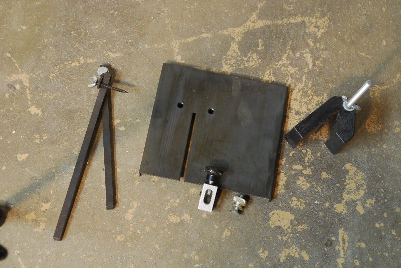

Here is some stuff that I need help identifying. I think the parts on the left are for the bandsaw circle cutter. I have no clue on the other pieces.

In your final picture above, the square black plate with the slot in it looks like a table for a 4x6 metal cutting bandsaw when used in vertical mode. Look here for example to see the saw ( I searched but did not find a pic of the table itself):
http://www.grizzly.com/products/4-x-6-M ... dsaw/G0622
I think the table is about 8 or 10 inches square.

The two pieces below the rectangular shaped plate: on the left is part of the circle cutter, on the right goes in the end of the slot on your bandsaw table. The fence bar is correctly mounted on the back of the table. The circle cutter mounts to the bandsaw table extension (on the right side of the table). The miter gauge does not appear to be Shopsmith. Looks like you picked up a nice setup. Congratulations.

Sell the 'extra' bandsaw, keep the power station!!

There appears to be a lower saw guard cover and a upper saw guard for the model 500. They can't be used on the 510, but wopuld be a nice upgrade for a model 500. You have a type "C" headstock which will bring your Shopsmith up to at least '92.
I agree, keep the power station.

I may have the only dissenting view on the bandsaw here. I have two. Normally, I keep a 3/4" blade on one to resaw wood and the other one normally has a small blade for cutting curves and small cars. This saves me time is finding, identifying the correct blade and changing them out. I can most times just change to the bandsaw with the blade loaded, then tension the blade and set up. But, this is just MHO. ;)

Actually, I am seriously considering keeping both bandsaws for that reason. Before I got my first Mark V, I started out with a small Craftsman bandsaw (1/4" blades only). I figured I would either keep both SS bandsaws or one SS bandsaw and the Craftsman. I will probably keep the SS ones since they have a higher capacity and take less space.
