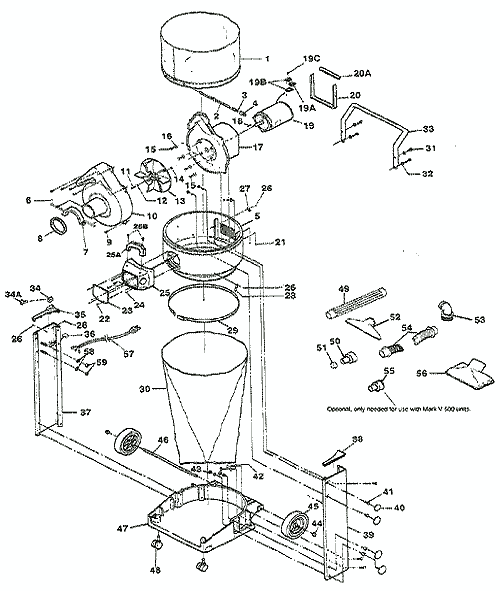

I think both ncc1701dhhr and robg may be having the same problem, something wrong with the impeller. Pull the dust cover off and then remover the plastic dust shroud so you can see the impeller. Is there anything stuck on it? Is any of the blades missing, nicked, broken?

Ed in Tampa wrote:I think both ncc1701dhhr and robg may be having the same problem, something wrong with the impeller. Pull the dust cover off and then remover the plastic dust shroud so you can see the impeller. Is there anything stuck on it? Is any of the blades missing, nicked, broken?
Have you tried this? I tried to get my impeller into easy view after I noticed the difference in volume between mine and the traveling academy's dust collector. I took several pieces apart, but when it looked like I would have to remove the enitre motor housing to get the impeller into view, I put it back together and went back to cutting wood. I suspected that dog hair was interfering, but I could see part of the impeller and didn't see any dog hair, so I decided that couldn't be it.
Anyway, "remove the plastic dust shroud so you can see the impeller" sounds like a relatively easy thing to do. But unless I missed something, the impeller is in a one piece housing that holds the motor and has to be lifted out of the stand to get easy access. Anybody have any suggestions?

robg wrote:Have you tried this? I tried to get my impeller into easy view after I noticed the difference in volume between mine and the traveling academy's dust collector. I took several pieces apart, but when it looked like I would have to remove the enitre motor housing to get the impeller into view, I put it back together and went back to cutting wood. I suspected that dog hair was interfering, but I could see part of the impeller and didn't see any dog hair, so I decided that couldn't be it.
I was getting already to tell you how easy it is, then I went to the exploded view. My DC3000 is built differently than what the picture shows. On mine there is a plastic shroud that attaches to impeller housing. By removing this shroud I have access to the impeller. It is not total access but enough to clean and inspect it.
I think on yours it must be a one piece setup now. My part 10 is actually two pieces on the impeller caseing and two a shroud or deflector.
[ATTACH]9[/ATTACH]
It looks like you have to remove more than I do. Sorry!!!

Thanks for looking Ed. I will call the help line and ask them what the best way is to get to it. I don't mind removing the whole unit. It looked clean though - so I don't know what getting to the impeller will do for me. *shrug* I do think my duct colletcion performance is sub par compared to other units I have seen though, so it's worth looking into.
