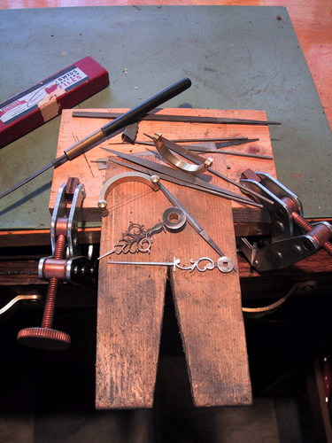

Better late than never.... The finished product looks great perhaps some of this will help on your next batch.
The bench block is a simple thing to make and the following photos should give enough info to make one. It is one of the handiest tools in my shop.
[ATTACH]8955[/ATTACH]
[ATTACH]8956[/ATTACH]
The surface you clamp it to should be pretty high. My bench is 37" high, this puts it in your precision working range. Magnification is also helpful, I find myself using my Optivisor more and more.
The saw should be held so the blade is vertical and the work is held down with your free hand, assuming it isn't holding a camera at the time.

An old project shown with a few files. It is hard to have too many small files! The box with the old Nicholson escapement files is a favorite.
[ATTACH]8958[/ATTACH]

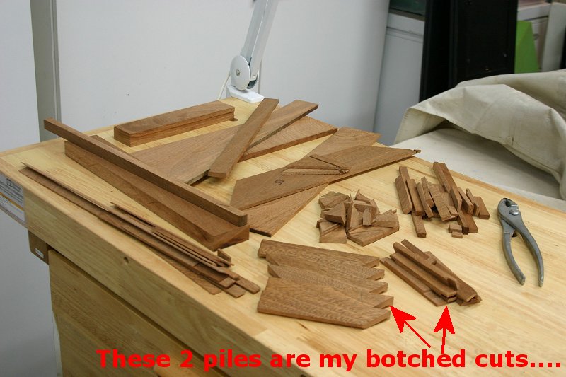

I started out with 2 B.F. (based on ACTUAL lumber dimensions) of African Mahogany (aka sepele). I had 4 nice left over 'scrap' 1 x 4 x 8 flooring pieces courtesy mbcabinatmaker along with a 1 x 8 x 32 board purchased at a local hardwood supplier.

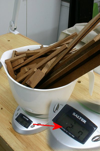

I kept all scrap as I went along. The photo below shows what was left over in the end.
[ATTACH]9050[/ATTACH]
The 'waste' weighed just shy of 2-1/2 lbs. Based on the pounds per B.F. info provided on Nick's website, that means I had about 1 B.F. left over.
[ATTACH]9051[/ATTACH]
Total ACTUAL material used was about 1 B.F. (works out to a 50% waste factor). That on-line board foot calculator I used worked great. Had I entered 50% waste vs. 20%, it would have estimated exactly.
