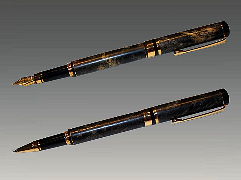

Had a couple premium Buckeye Burl pen blanks from PSI setting on the shelf and thought I'd give them a try. I turned this Parker style rollerball pen and fountain pen set with them. Pretty striking grain on the wood. Ended up with one inclusion on one of the blanks, so I gathered a little of the shavings from the blank and took some CA glue and filled it with that. Turned it down again and you simply can not tell where it was. I'm really pleased with how well it filled in.

Those are great looking pens. Did you use a CA finish or a friction polish?

Thanks CV, I normally use EEE Ultra Shine and Shellawax Cream unless I'm working with some really pithy wood or something porous like a corn-cob. Then I'll use the CA glue.

I'm not sure which is better, your pen turning skills or your photography skills. Great looking work.

I've been told that too. :rolleyes: I will say though, now that I'm getting used to my pen-turning chisel set, I'm doing better still.
