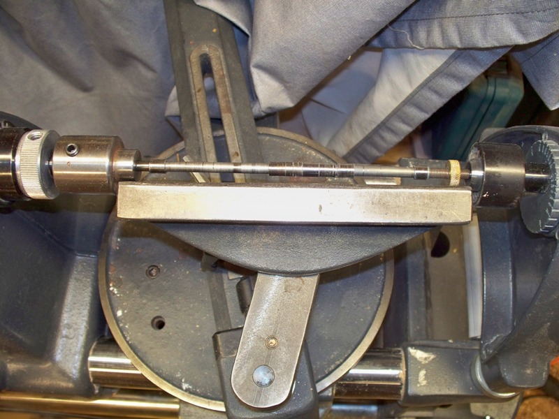

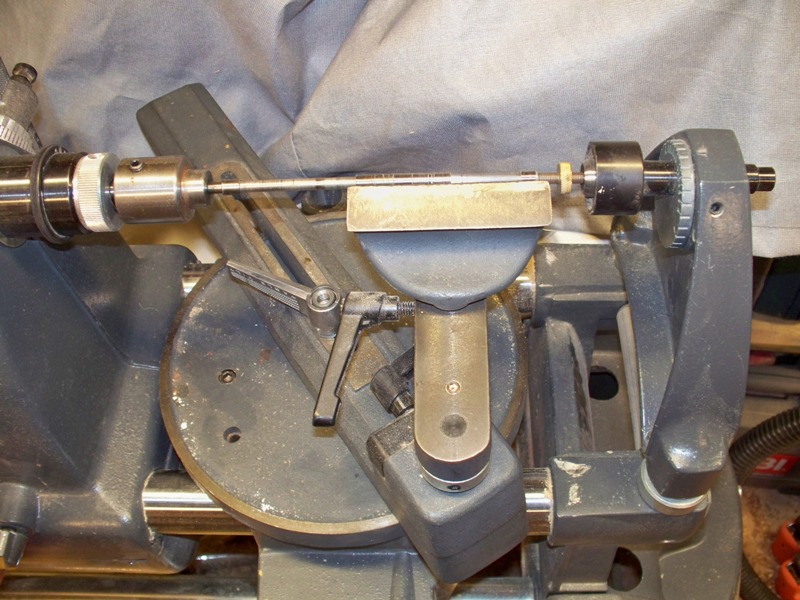

I have the universal tool rest system 555868 from shopsmith and have no problem mounting my pen mandrel between the headstock and tail stock with a live center. I believe the universal tool rest gives one more flexibility compared to just a tool rest mounted on the carriage. I either use the short tool rest mounted on the banjo and will do one side of the pen then relocate it to get the other side or I have also used the longer tool rest without having to make any adjustments. With the longer tool rest, you can only get about a 1/4" gap between the work and tool rest which has never caused a problem for me. You want to be able to have the tool rest as close to the material as possible to prevent the possibility of the chisel getting down between the tool rest and work. Like I said, it has never been an issue for me.[ATTACH]9148[/ATTACH]
[ATTACH]9149[/ATTACH]
- Short Tool Rest.JPG (163.8 KiB) Viewed 2218 times
- Longer Tool Rest.JPG (155.02 KiB) Viewed 2220 times
Ron from Lewisburg, TN
