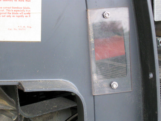

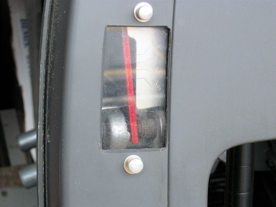

I made my window opening a little over 1 1/2" wide and a little under 3" tall. Used a Dremel Multi-Max to cut the hole...very handy tool, BTW.
[ATTACH]9228[/ATTACH]
Used same plastic as used on jigsaw window (see other post). I lined the bottom up with the flange of the cover. The window could be a bit smaller, however, I like it!
[ATTACH]9229[/ATTACH]
- window outside.jpg (40.76 KiB) Viewed 3212 times
- window inside.jpg (46.41 KiB) Viewed 3210 times
