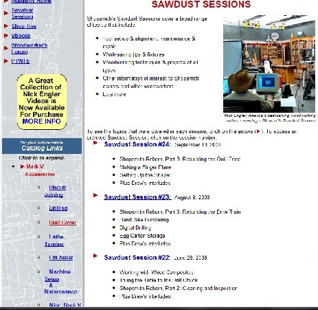

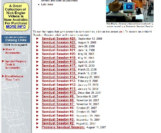

Watch a few of the Sawdust sessions and see if yours sound much different than the ones in the videos.
http://www.shopsmithacademy.com/Sawdust_Sessions.htm
BTW, a strange browser thing. In Chrome, I get a list including descriptions of all the videos. In IE, I only get a list of the editions, and have to click on the link to open the respective table of contents.

paulrussell wrote:Watch a few of the Sawdust sessions and see if yours sound much different than the ones in the videos.

I.E. Just does not have enough Cowbells!:D
Edit: Nor dog whistles!
