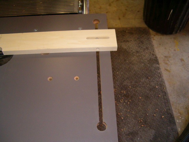

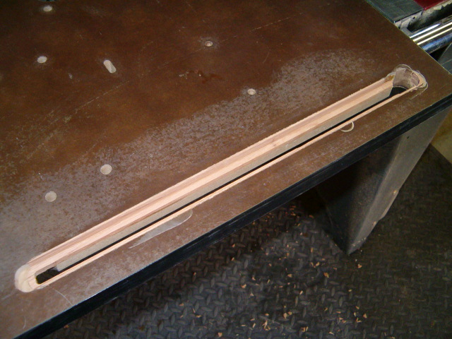

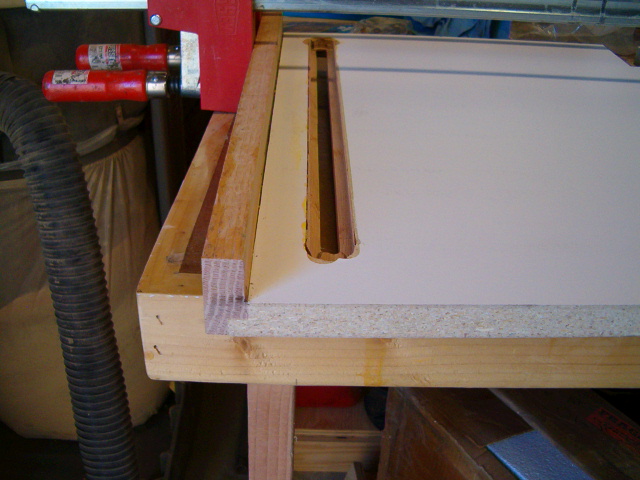

The making of the fence and sliding table was really pretty straight forward. You need to drill the through holes on the front (user side) of both tables and then rout some grooves as shown.
I had problems because I went from memory, which is always suspect, and drilled 4 holes, one on each end of the grooves. DON'T DO THAT!!!!!
Because the center of the original OPR table is a medium of relatively soft fiber, I thought it best to line the grooves with oak. Then when the carriage bolts get tightened they are a lot less likely to chip away at the bottom of the grooves. This required me to fill the slots and make a second set of grooves, this time in oak. This second time the router bit walked a little on me and there are a couple of spots of irregular grooves. Ugly, but still functional because of the solid oak. I managed to plug the bottom of the back (extra/unwanted) holes with the oak inserts. The fourth photo shows the top of the sliding table with the oak inserts, prior to re-routing the slots. This operation caused the rear holes to be plugged so carriage bolts don't pull through. (also shown in the 1st photo dealing with the factory table)
You may notice the guide rails on the sides of my sliding table are not attached as shown on Nick's plan. (second photo) This method also works, but certainly not any better than the plan. My siding table was made from melamine faced fiber board. I'm happy with the melamine.

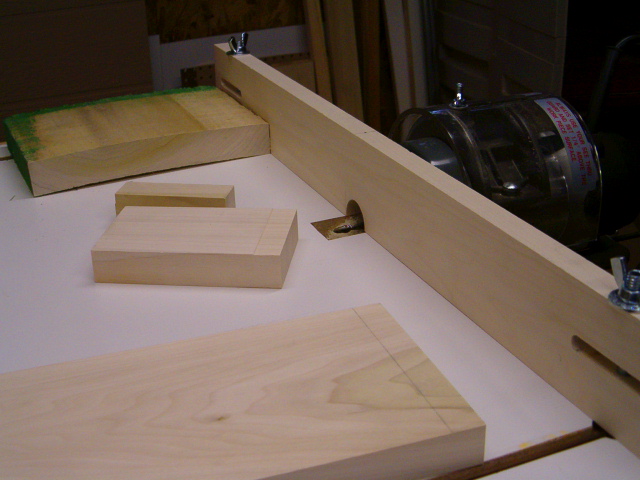

Sorry, I can't find a photo of the entire fence, but the pix showing half of it shows it is following Nick's plan. I made it from a 3/4" poplar board. This fence can be used either flat or vertically on the table. The last photo shows a set-up for routing tenons.

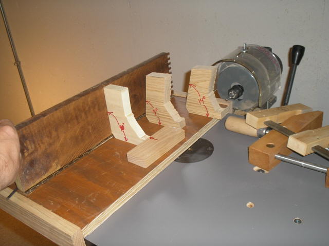

I thought a lot about a challenge lately, and finally put a jig together. I wanted something to help with box joints and dovetail joints on my OPR.
This jig is especially for the OPR in Horizontal mode. It slides left to right. There is a hinged support-board which can be clamped at any desired angle, as long as an angle-reference block is fabricated. I have made 90-degree, 90-14 = 76 degree, and 90-9 = 81 degree blocks. The 90-degree will be for general cuts and box joints. The other two are meant to complement some dovetail bits I have; I'm looking forward to trying some "through" dovetail joints with this setup.

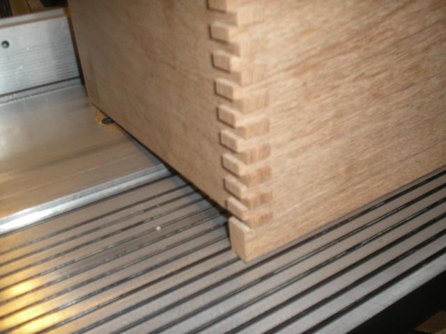

To date I just tried making box joints. I used the Adjustable Stop Collar under the table to index each cut accurately by 1/2". It didn't come out too bad!
