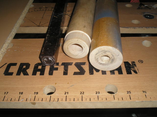

Temperature offset is a real friend, especially the chilling of the bearing assembly.
Clean, wax and buff the headstock casting bores if not already done.
Have a Quill in place when you push in the Drive Sleeve, to help it be driven perfectly on-axis.
A "pusher" with the right dimensions for your bearings is very helpful, such as I've made here:
[ATTACH]9578[/ATTACH]
- My Custom Tools.jpg (47.41 KiB) Viewed 4033 times
