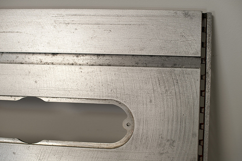

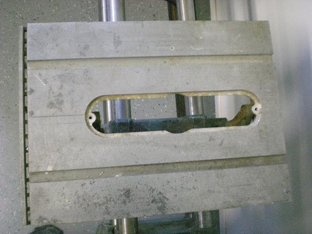

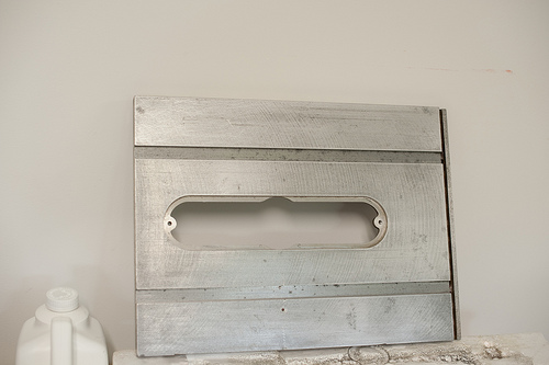

Here are some before and after pics of what I've done so far.
First I used some Citristrip and painted it on with a paint brush and left it on overnight. Then went over it with some fine (#00000) steel wool and Odorless Mineral Spirits. This got a good portion of the dark spots off, but I was still not satisfied. I tried to fine some Fine Brass Wire Wheels for my grinder, but could only fine steel or brass coated steel at the big box stores. I have since ordered some from Amazon. In my Noobie excitement/impatient, I took my orbital sander and 220 grit and went to it. About 30 seconds into this process I got the impression I was removing more Aluminum than Alox and stopped. I may try some naval jelly next while I wait for my wire wheels to come. Unless anyone advises against this.
Note on After Pic: (The obvious curved lines appeared before my sanding experiment and appear to be old damage that was hidden under the alox)

I do not think that is a good idea! It is for steel, not aluminum, and is an acid(eats good with the bad).
Fine steel wire wheel will do a pretty good job. Understand it will go in stages. The alox will polish, then get removed creating a lighter but duller finish. Which finish you shoot for is up to you. If ya got dark 'spots' then the heavier removal will be more satisfactory. Resist the temptation to press hard, let the wire wheel do the 'work'. Getting it all even is a challenge. Changing directions will show!
It is not going to get to looking like a new one, be reasonable in your expectations. Its gonna change with use!!!
