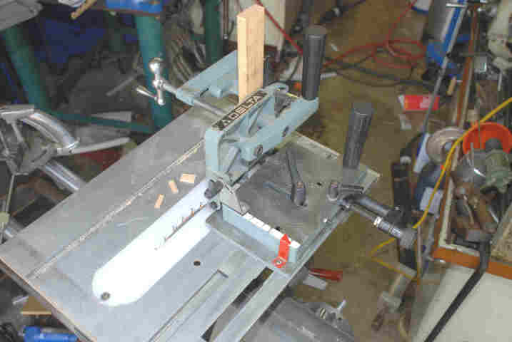

Due to space constraints in my shop, I've started using my old shopsmith again.
My all time favorite joint is a"'mortise, and tenon". I have a dedicated mortiser. I needed to modify my delta mortise jig to fit the Shop smith.
Of course the guide bar is too wide, and thick to fit the miter slots on the shopsmith. also the slots are closer to the blade than my previous "Jet contractors saw".

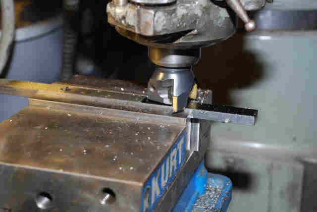

first task was to disassemble the jig. I milled the thickness of the guide bar down to fit the depth of the shopsmith miter slots. I used a Bridgeport mill.

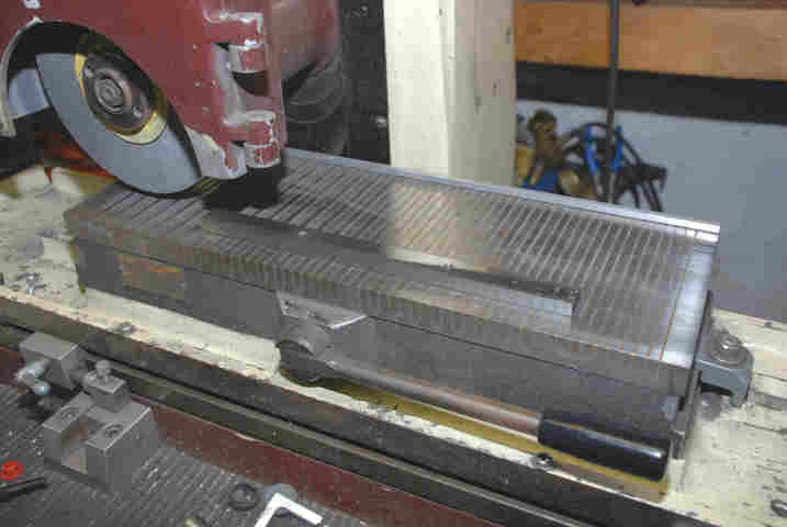

Then I used my surface grinder, and ground the sides of the bar for a nice tight fit in the slots, and also ground the top to remove the tool marks from milling.

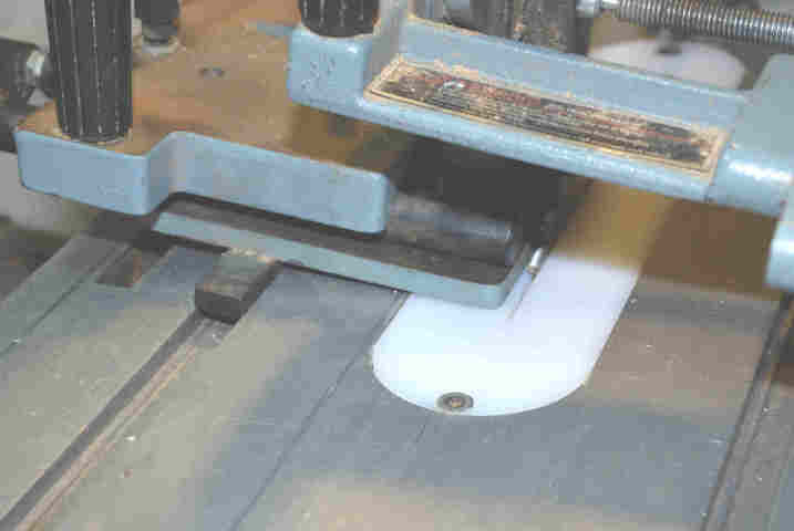

I had to drill two new holes in the base about .750" back so that the base would properly clear the blade, due to the narrower distance from the slots to the blade.
I cleaned and lubed, and waxed everything, and reassembled the jig.
I aligned everything, and made a "test tenon".
Here's some photos
The original jig.
Milling the guide bar.
Grind the bar on the surface grinder
Finished on the Shopsmith.
Note my home made zero clearance insert, made out of 1/4" UHMW poly.
