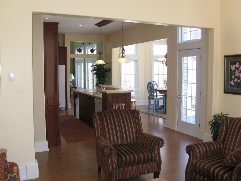

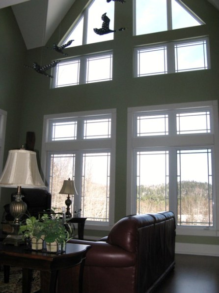

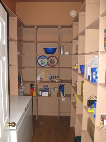

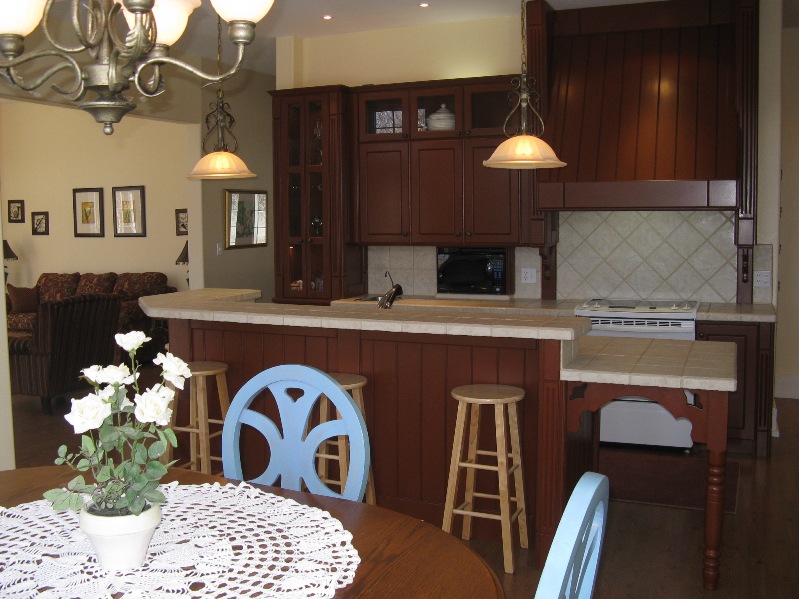

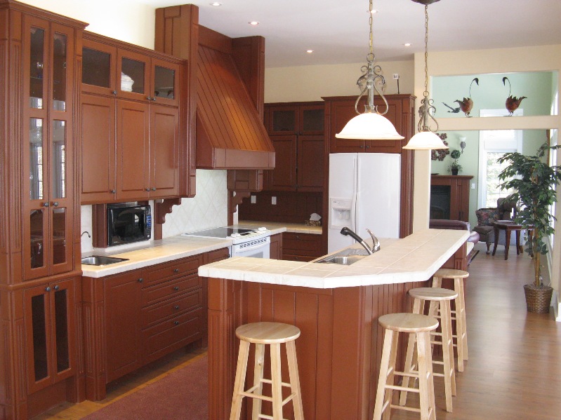

All of the "wood" in the attached photographs is mdf. Even the kitchen cabinets are mdf. I even turned the legs for the kitchen island out of mdf.
Initially, I was going to change the cabinet doors to cherry when money was available, but I ended up selling the house before replacing them. They turned out great anyway. The cabinets are made from a good quality plywood however. Just the doors and the trim are mdf.

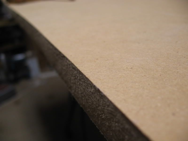

Here's a closeup (camera set on macro and placed right on the edge) of part of a 3/4" sheet of MDF that I use as an assembly table (placed on top of my Craftsman table saw). I got this from Home Depot.
It looks the same on the flip side. The curve off into the background must be an optical illusion caused by the macro focus because it has remained flat. The corners are showing a little wear however from rolling on the concrete floor when I pick it up or set it down.
