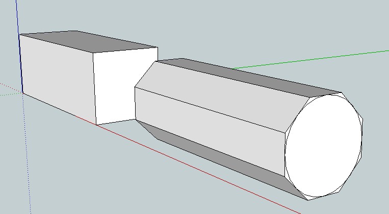

Thank you for the reply, but how deep of an X do I need to cut ( by any chance do you have any example pictures)? So instead of using the gouge tip, are you saying to lean the tool back to the bevel? I have a question about the Shopsmith rest; am I suppose to follow the angle of the rest since I;m new to this or is it better to just get my own feel for the lathe?
Hi,
Not sure how you have prepared the work piece before you put it on the lathe so I don't know if you tried to get it as round as possible before you started attempting to round it with the lathe setup.
If you just stuck the 4 x 4 in the lathe you are working way to hard. You need to use the table saw to cut some of the edges off so it looks like a stop sign (8 sides).
Here is a quick sketchup view
[ATTACH]9861[/ATTACH]
Hope this helps some,

vanmeter2r
Posts: 33
Joined: Fri Apr 23, 2010 11:45 pm
lathe
Post by vanmeter2r »
darn, I'm doing it the hard way, I knew I should have rounded the sides on the shop smith, but I think with my excitement to start my first project on the machine, I just got blinders. Thanks, I will just cut another piece and trim the sides.
