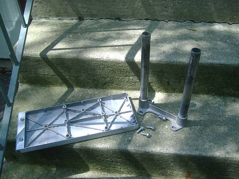

In this first image you see the table top and "legs" after then have been separated. (In my case this happen a few years ago and the spacer/washers have since vanished in to a drawer so they are not pictured).

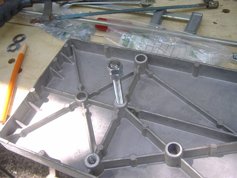

In better times I would have purchased studs but at a couple of $$ per each 3/8"-16 x 3" stud I opted to cut a threaded bar. A 3 foot section of threaded rod was about $4.50ish and you can get the 4 you need and and still pay less then four studs would cost and have material left for another project.

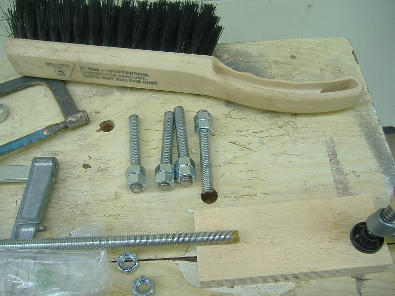

In this next picture you can see the 4 studs with two hex nuts in a jam nut configuration. As a bonus I'll show you how I cut the studs to length later in the thread.
[ATTACH]9934[/ATTACH]

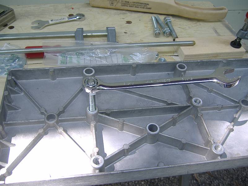

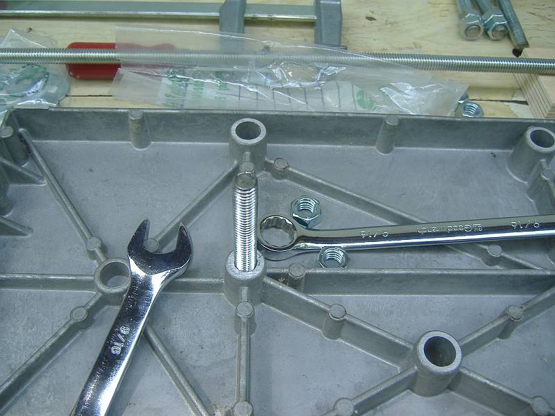

Putting the studs in is not a big deal as long as you have used a grinder/file/tool you like to use to clean up the threads where they were cut. I like to do it at a grinder and then follow up with a wire brush to make sure all the little wire bits are removed. In this photo you can see it just threads in until you can't get it any farther with your fingers.
[ATTACH]9935[/ATTACH]
To go the rest of the way you simple use a wrench on the top jam nut and snug up. I don't try to get it too tight as I always use a washer and nut to lock it in place anyway.
[ATTACH]9936[/ATTACH]

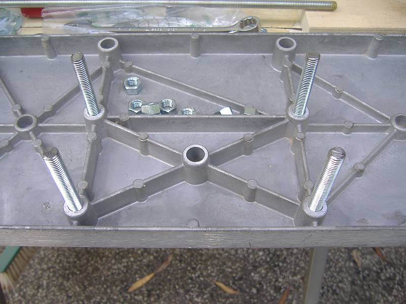

Un-jam the nuts and remove them. When all 4 are done you are ready to to do a bunch of fun stuff with the remaining parts.
[ATTACH]9937[/ATTACH]

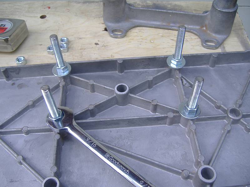

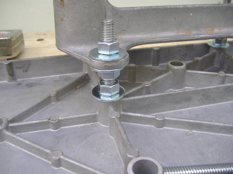

Here we are with the 4 studs in place.
[ATTACH]9938[/ATTACH]
I like to add a washer and nut when I use threaded rod as a stud. This makes sure that the stud stays in place. You may find you would rather not do it his way and I have no problem with that as this application is not very critical in this respect.
[ATTACH]9939[/ATTACH]
Having fun yet?
OK here is the picture of the stack up.
[ATTACH]9940[/ATTACH]
Each stud gets a nut and washer followed by the legs and then a washer and nut. Step one is to level the top with the main table. The top nut position is used to make that happen. Once that is about right you then slide the table forward/backward and twist to have it aligned with the front and side of the main table. Snug the bottom nuts and check the alignment and position and adjust as need until you have it right on. Tighten the bottom nuts and check again...

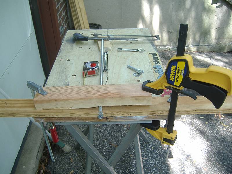

Let's start with an over all image of the complex setup.
[ATTACH]9941[/ATTACH]
A couple of thing I want to point out in the picture. First the bar is on some scraps of 3/4" plywood so it doesn't damage the work table top. Having the two pieces make it in the same plane and easier to work with. The top "clamp" is a 2x4 clamped tight on the left side with the quick clamp as the working end. With out the right clamp tight you can move the rod to make sure it is parallel to the line on the table top thus square to the clamping area. Once you quick clamp it the rod is no longer able to move or to turn.

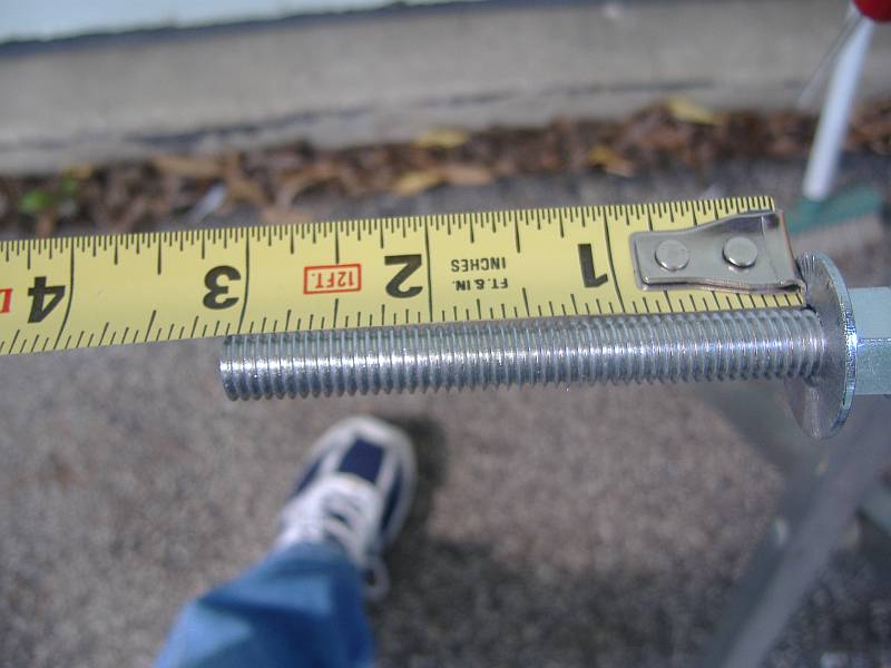

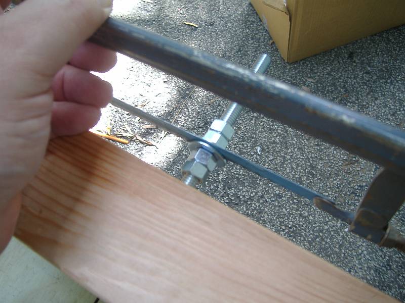

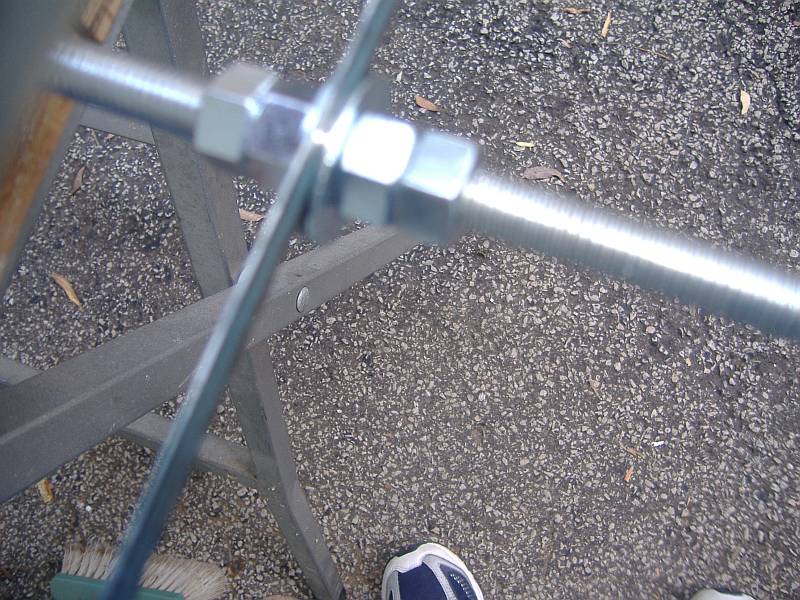

Adjusting the cut is done by positioning the jam nuts and washer the length of the stud plus 1/16" from the end of the rod. With the nuts jammed you then bring the second washer and set of jam nuts so that the hacksaw blade can just move between the washers plus a smidgen. Check it again after jamming the nuts then get the rod in position to begin the cutting.
[ATTACH]9942[/ATTACH]
[ATTACH]9943[/ATTACH]
The washers act like a guide and then it is just a matter of making the cut. Keep in mind the washers will get scrapped up so they are sacrificial but I keep them for next time... And also the parts involved get rather warm so be careful when grab them after the cut....
