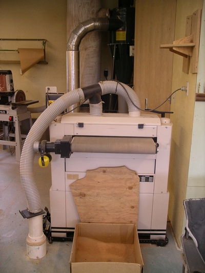

I have this one. It's a dual drum generic identical to the General International. This one is sold here by House of Tools under their Canwood brand.
[ATTACH]10035[/ATTACH]

They are invaluable for certain jobs but can be very temperamental and can burn up expensive sandpaper if you aren't very careful...even if you are. Also there are certain oily woods like cocobolo for instance that you just can't even think about. I use mine a lot in veneer leveling after assembly and veneer prep prior to assembly. Also great for tabletops etc. glued up from several pieces.
