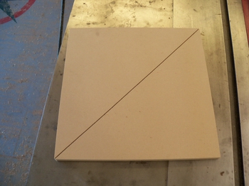

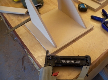

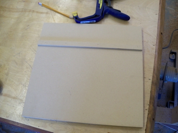

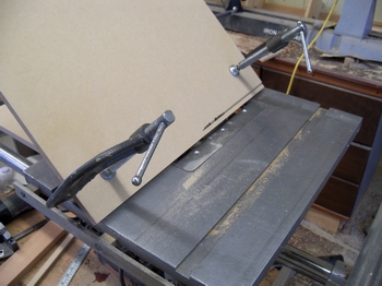

On my current project I've done it with a simple sled. The 45 deg is very accurate if you just rip a square and cut it diagonally. The larger the square, the more accurate the 45. My project is smaller than yours but my 10 ER table is smaller than yours too. I'd just build a larger one for your larger work. There are more photos of this sled in operation in my thread: http://picasaweb.google.com/paulm549/Cu ... directlink

Tack a strip on the bottom to follow the miter slot
[ATTACH]10218[/ATTACH]
Cut your 45's
[ATTACH]10219[/ATTACH]
Assemble with room for saw to re-cut your edge
[ATTACH]10220[/ATTACH]
Add clamping bars
[ATTACH]10222[/ATTACH]

1) Set your table saw at anywhere you like, don't have to measure. Cut a piece of stock that wide. Turn it 90 deg and cut it again without changing the fence.
2) Draw a line on the resulting square from one corner to the diagonally opposite corner of and cut the line.
Is that really what you were asking?
Paul M
