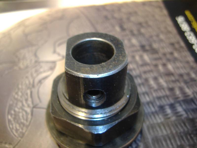

about the "nub" on a saw arbor it got me thinking about the recent shopsmith I picked up and the odd hub it has... well more like had.
While the reference post may or may not have a purpose that we can figure out I think mine is simple a mistake in manufacture, followed by a previous owner not taking it up with the manufacture be that shopsmith or ???
Can you spot the issue?
[ATTACH]10233[/ATTACH]

The flats for the wrench are knot equal in thickness.
