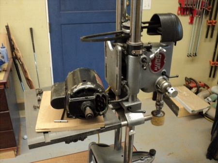

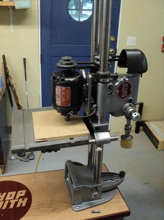

Another benefit of service in the drill press position is if you reverse the table to the other side of the tubes you have a nice shelf to support the motor. I was able to get the idler shaft assembly out for a complete cleanup and lube job without removing the motor wires from the switch. Reinstalling the motor screws was also very easy in this position.

MikeG wrote:Another benefit of service in the drill press position is if you reverse the table to the other side of the tubes you have a nice shelf to support the motor. I was able to get the idler shaft assembly out for a complete cleanup and lube job without removing the motor wires from the switch. Reinstalling the motor screws was also very easy in this position.
Thanks for the tip. As luck would have it I needed to remove my 10ER motor today to fix a small wiring issue. I remembered your post and it made the job much easier.
[ATTACH]10267[/ATTACH] [ATTACH]10268[/ATTACH]
PS: Thanks JPG
