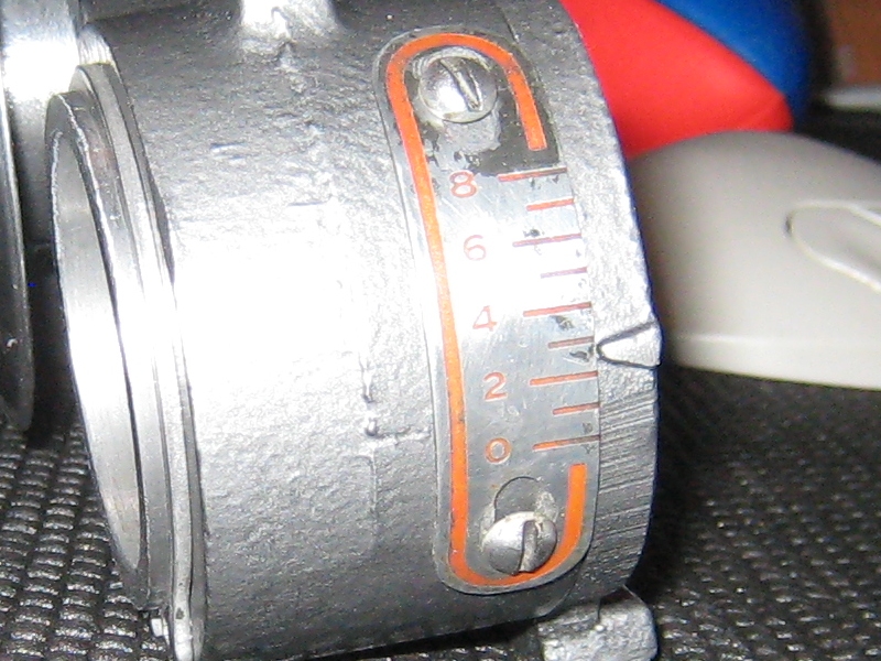

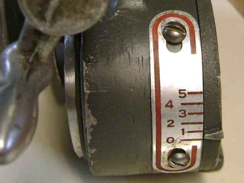

wlhayesmfs wrote:I have had both, there is no difference in the 8 or 5 just the numbers on the label.
The '5' has positions labeled 0,1,2,3,4,5.
Can I assume(correctly) that the '8' is labeled 0,1,2,3,4,5,6,7,8 and that the 0 and 8 are located the same as the 0 and 5 are on the '5'?
Does anyone have a speed chart that correlates the 0 thru 8 to rpm's?

JPG40504 wrote:The '5' has positions labeled 0,1,2,3,4,5.

Notice how the 0 thru 8 range takes up almost the entire distance between the mounting screws as compare to 0 thru 5 range.heathicus wrote:I looked around and found these pictures at the 10ER Yahoo group.
[ATTACH]10400[/ATTACH][ATTACH]10399[/ATTACH]
Thanks Heath!! It appears the '8' was planned all along(?). It also appears the '8' has a wider range(shorter lever arm on the pulley 'pivot')(??).
Anybody know if the actual speed range is the same?(probably unless the speed control pulleys are a different size). i.e. 0=0 5=8
0..... 1..... 2..... 3..... 4..... 5
0...1...2...3...4...5...6...7...8
?????????????????????????? 0=425/1850 5=1600/6800
?????????????????????????? 0=425/1850 8=1600/6800
