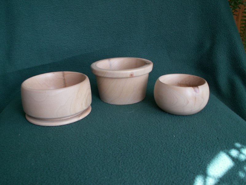

I have turned a couple of small bowls- first lather project with my Mark V. Removing stock from the inside was tough, a lot of gouging, pulling, etc. What is a good speed, tool and technique to use to remove inside stock? these bowls are 4" in diameter.
Thanks![ATTACH]10304[/ATTACH]
- PICT4836small.jpg (71.54 KiB) Viewed 5282 times
VERY nice effort. the one on the right looks like you got into the hollow-form range.

Thanks everyone-
The wood is actually Sycamore from a sentimental old tree removed from my wife's childhood home. Finish is simply Johnson's wax. I have a 3/4", 1/2" and 3/8" gouge- nothing fancy. The larger gouge worked best. I do have a speed reducer and used it for roughing out the interiors. Try as I might to be cautious it would still grab on occasion and slip the belts in the reducer. I suspect that I should learn tool sharpening skills first. I may invest in a wood turning DVD I saw mentioned on this site.

Ya need a bowl gauge or a round nose scraper for the bowl inside. I'd say those 1/2" and 3/8" gouges are spindle gouges. The 3/4" is probably a spindle roughing gouge.
Your bowls look great! I'm glad you chose a relatively soft wood to start with.. the first bowl I made was purpleheart, and it was a fairly rude introduction considering how hard and tool-unfriendly it is. I did learn pretty quick how to sharpen my tools, but I'm still way behind the curve on getting a good edge.
I just made my first hollow form bowl. I tried to make a hollow bowl with the purpleheart, but I couldn't get my bowl gouge to cut the inside aspect without catching really bad. I had a few incidents where it caught bad enough to launch the tool out of my hands and across the room.
