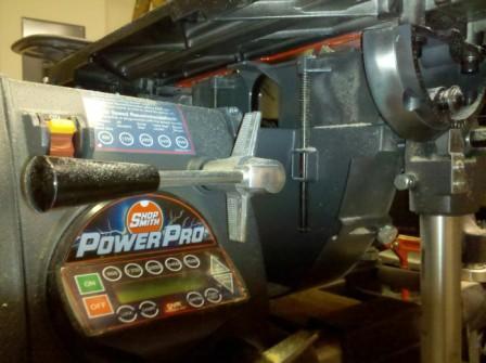

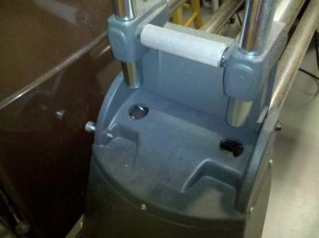

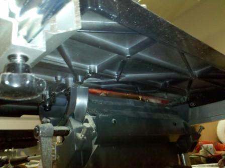

Here are some pictures
Brian
Mark 7 PowerPro,Jointer

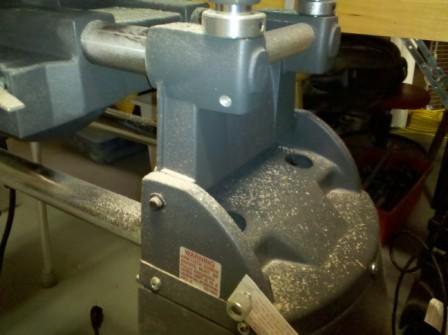

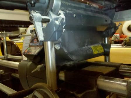

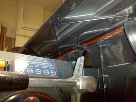

One More
Post by bstadtler »
Here is one more let me know if you need different angles
Brian
SDSSmith
Posts: 1940
Location: San Diego, CA
Post by SDSSmith »
bstadtler wrote:Here is one more let me know if you need different angles
How about a shot of the table rotated 90 degrees clockwise? And, the machine in the vertical position for under table shaping (right side raised up)? Close up shot of either arm that rotates to put machine in vertical mode.
Thanks in advance.
Rob in San Diego
1) Head on shot of the trunion, showing the angle graduations.
2) A shot of the left end with it raised to vertical.(both the 'tie rod' piece and the bench tube end casting).
3) Details of the securing and releasing mechanism.
4,5) Assuming it does tilt the opposite direction, a similar set of pix of the right 'end'.
This will either lead to more questions/requests for pix, or stop the speculation completely.
Closer look at the initial pix reveals:
Rack teeth on only the 'normal' side of the table support tubes.
Stops at 90 and 45 degree same as 'normal' 520.
Trunion lock in same location as 'normal' 520.
Must conclude 90 degree right rotation not possible = under table shaping not possible with 'normal' table.:(
Table appears to be std 520 issue.
This leads to the ??? of why refer to it as a VII? Runs in reverse???

damagi
Posts: 927
Joined: Wed Jan 06, 2010 6:06 pm
Location: near Seattle, WA
Post by damagi »
If the table is no different (which seem like the case based on the photos), then it seems like getting a pivoting end off of ebay would put you most of the way there...except for figuring out an easier way to remove the pivot bar. In fact, from examining the photo it looks like the existing ones could be modified to provide that functionality...hmm =)
One thing to know would be whether the bench tubes or way tubes are longer/shorter than normal.
Also - a shot of the ends proped up a little would be great.
