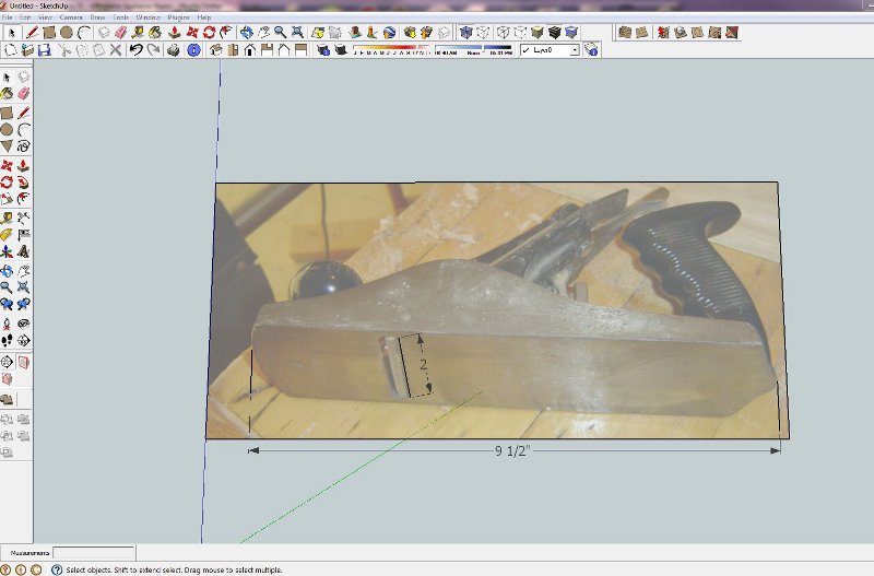

I bought this Ace Hardware hand plane years ago and works so well for me, but I don't know what style it is. The foot is 9½" long and the blade is 2" wide. overall it's light so will chatter if I let it, but I like it

It's a Smooth or Smoothing Plane.

Not quite sure what you're looking for with the "style" - but that would be roughly equivalent to a Stanley No. 4 - a smoother plane.
Nos. 5/6 - used for roughing stock to initial flat
Nos. 7/8 - used for jointing stock after 5/6
Nos. 1-4 - used for final preparation of stock before finishing
(of course the above is largely based on how you grind the blade in the plane)
hope that helps

From looking at the picture I would say it is a bench (Smoothing) Plane. The short length makes them ideal for trouble spots where a board may have grain that changes direction and has to be planed in different directions along its length. These planes cut a very fine shaving giving less chance of tearout.

as others have said, it is a bench smoothing plane. it is equivalent in size to a Stanley #4 or a Millers Falls #9. yours has an interesting tote with the finger grooves.
yours is probably made of ductile steel and is more likely to survive a fall to concrete than the older cast iron planes. you can often find good deals at garage sales or other woodworking forums on user planes. the older planes (WWII era and earlier) are likely to be heavier than the one that you have. the latest upgrade (version 3) of the Woodcraft Woodriver planes seem to be a good price point for good quality new hand planes.
