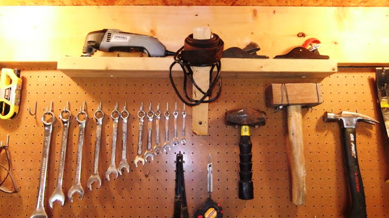

Just thinking out loud here, but I can envision a tool holster perpendicular to the pegboard would apply too much leverage to the masonite, resulting in pull-through, unless your pegboard is uber-nice hardboard or metal. I have a wall of masonite pegboard that I have straddled with a 2x4 cross member near the top to shelve awkward tools, to prevent pull-through (see attached). Come to think of it, that picture shows my mallet and 3 lb hammer mounted with two 8d nails bent in a bit of an S-shape. I bet you could build a set of holsters that have slots in the back to accept the head of the nail and have a nearby shelf for the charging station. But wouldn't that take up a lot of pegboard slots that could be used for smaller tools?

- DSCF1084.JPG (204.41 KiB) Viewed 10114 times
