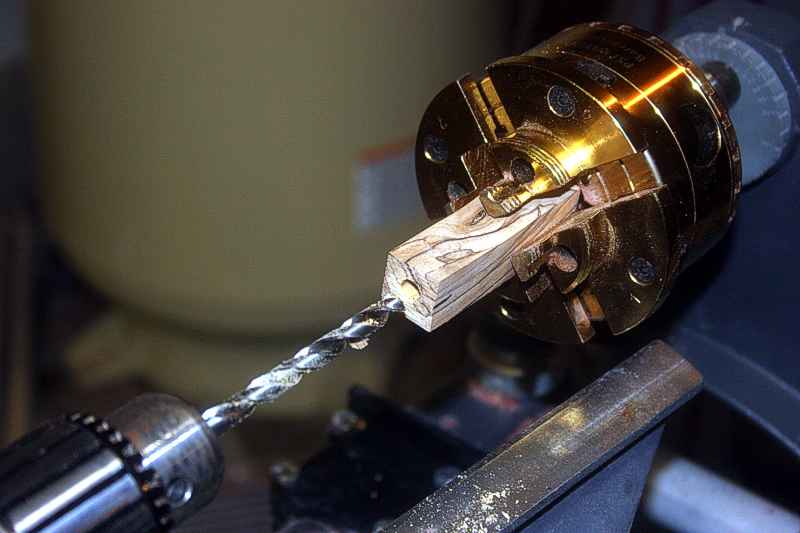

Mike, here's what I do to drill my blanks, and I think it works great.
[ATTACH]10701[/ATTACH]

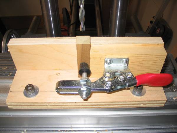

This is how I do it. I built this jig for pen blanks but it works for other small pieces
Pen drilling fixture
[ATTACH]10702[/ATTACH]

tom_k/mo wrote:Mike, here's what I do to drill my blanks, and I think it works great.
That is an awesome, pretty chuck you have there. Is that a Barracuda TiN coated?
tom_k/mo
Posts: 856
Location: St. Louis, MO
Post by tom_k/mo »
mgdesigns wrote:That is an awesome, pretty chuck you have there. Is that a Barracuda TiN coated?
Yes it is.

mgdesigns wrote: Then I check square and parallel to the drill bit and side of the blank and set depth to 1/8" past blank length, and drill on thru in 4 stages. Works well, and quickly. I did 20 blanks in 10 minutes or so.
Another newbie question: When you say "blank". Do you drill each half seperatly or drill the whole thing? :confused:
Mark V 520, Ryobi 12" mitersaw, Delta 10" tablesaw, DC 3300.
wa2crk
Posts: 3080
Location: Leesburg, Fl
Post by wa2crk »
I drill my blanks separately. The fixture that I use (see post #6) orients the blanks correctly provided that you mark one side of the whole blank with a marker. The I drill the hole with the marked side facing me and everything lines up OK on the mandrel. By the way also mark the original blank with an arrow to indicate "up".

Tom k/mo;
I like your chuck idea. Have you seen the PennState drilling jaws for the chuck?
The jaws are two in a set and they have a notch in the grip of the jaws which grab the blank on two of the opposing corners. This will center the blank for drilling. If I put an order into Penn State soon I will get a set for my chuck. Item #CJAWPEN on page 52 of the spring 2010 issue 103D.
Bill V
tom_k/mo
Posts: 856
Post by tom_k/mo »
Bill, I've seen that chuck that PSI offers. It's pretty slick, and if I didn't have the Barracuda I might have gotten one, but the Barracuda does just fine. FWIW, I've tried mounting the Barracuda on both ends, and have better luck mounting it on the tailstock and mounting the chuck on the quill. IF by some chance your blank isn't chucked exactly square in the chuck and it wobbled when turning (from the quill end) it would make the hole oversize. If it's not exactly centered in the chuck and the chuck is mounted on the tailstock you just get a hole that's slightly off-center, but VERY slightly...
