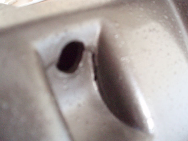

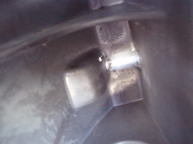

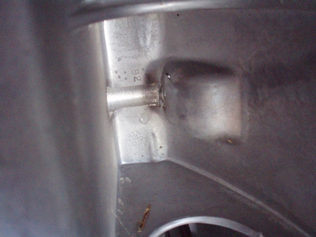

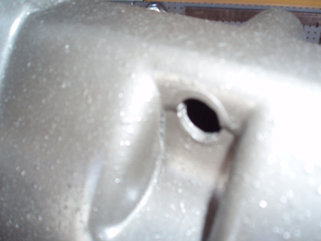

I am putting together a second Mark V with used parts collected from here and there. Everything has been moving along well and I was about to begin reassembly. I was inspecting my paint job and that is when I noticed two cracks in the Headrest. They are located under the Headrest Lock Handle and I believe that is why I never noticed them before.
I have attached some pictures - to show where the cracks are located.
My question: Is this an appropriate application for JB Weld?

Am I correct in saying that the Headrest Lock is the ONLY source of pressure that would exacerbate this crack?

Because it is cast, I would say yes. I have used JB Weld on cast pieces and parts. You cannot weld cast material, which JB Weld has turned to be a wonderful effective alternative.
If you are unfamiliar to JB Weld, be sure before application you can brace and hold your piece steady in order for the repair to remain effective. JB Weld is a fluid of sorts, and until that intial half hour passes, the bonding material will flow if given chance.
Roughing up the surface where you will be appling the weld is helpful, and to help 'dam' the weld, you can use simple modeling clay or glue a wood frame which can then be removed later.
I have never used JB Weld on a ShopSmith, so good luck.
A cracked piece that's still attached to the parent casting is indeed tricky, especially where yours is located. If it were completely broken off, that might be easier to fix! I would think you would need to make the crack BIGGER in some way, like drilling or grinding it out, in order to get the JB Weld in the crack... and that looks to be hairline in places.
I believe the cast aluminum can be welded without blowing it out - just not stick welded. Nick Engler mentioned it was possible in one of the SawDust Sessions (#21 - #24). If you have access to an oxy-acetylene rig, you can braze it back together. I also ran accross a "welding" compound called Alumaloythat is supposed to weld cast aluminium with just a propane torch and no flux. There are other similar products out there like HTS-2000.
