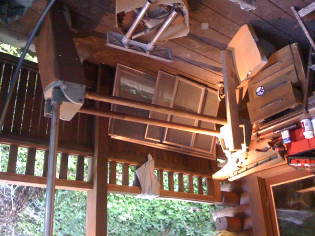

Hello Everyone. My 86 year old Grandpa gave me his Shopsmith Mark V last month. He bought it new in 1956. I think it is a really think it is a well designed tool and I would like to restore it so that I can use it to make musical instruments.
The Mark V has been stored for years and has the usual rust built up.
Today I removed the headstock and am trying to remove the way tubes but so far I can only get one off. Any recommendations on how to get it off. I got stuck at step one.
I plan on taking apart the headstock, cleaning and oiling it, perhaps updating the quill to a double bearing, and also repainting. I am trying to find a cheap battery charger so that I can do Electrolysis on some of the parts.
As for the way tubes, once I get them off, I am gonna place them in a PVC tube with a potatoe and see how that science experiment goes. I already have the four 3" PVC pipes and four potatoes.
Any suggestions on how to remove that way tube I would apprcieate. I used wd40 on it. and also reattached the the other end of the way tube to it's joing mount and tapped it with a hammer. no sucess.

Well I managed to get the stuck way bar loosened so that it will turn about half way. I thought since it was turning that I'd be able to get it off if I tapped the attached "Way Tube Tie Bar" at the other end. Well I tapped a little to hard (more like whacked) and I broke the "way tube tie bar"
still haven't gotten that way tube out yet though
[ATTACH]10873[/ATTACH]

Looks dry as a bone! Did you apply some penetrating oil?
Maybe it's time for some JB Weld. Check out mickyd's broken casting fix. After paint you can't tell anything was ever wrong. Can anyone out there help russaw with a new tie bar if need be?

Welcome to the forum russsaw. Your now have a classic machine that will clean up fine and will last you your lifetime. I can't give you any heat for your disassembly 'fubar' because, well, schtuff happens. We call it 'reverse restoration'! I've done it.....a couple times. I've learn patience and asking questions since.
For your next restoration, the secret to taking the stubborn tie bars off is gentle alternating tapping, going from one way tube side to the other. The tie bar jams very easily so it has to come off virtually dead straight.
Get yourself some 'PB Blaster' from Home Depot to make disassembly of rusty parts easier. Many folks on the forum also rant about a product called 'Kroil'. Didn't work at all for me but maybe I got a bad batch.

These be common and reasonable(usually) on e-bay. Any color/model will work except the 10E/ER version. IMHO replacement is preferable to jb-weld etc.russsaw wrote:Well I managed to get the stuck way bar loosened so that it will turn about half way. I thought since it was turning that I'd be able to get it off if I tapped the attached "Way Tube Tie Bar" at the other end. Well I tapped a little to hard (more like whacked) and I broke the "way tube tie bar"

The SS uses aluminium castings, and a broken casting that needs to bear weight needs to be metal, not JB-Weld. A broken and JB-Weld repaired casting, however, would make a great pattern to make a green-sand mold to cast a new part!

Maybe it's possible to braze this tie bar back together if Russ doesn't want to build a foundry.
The cheapest course of action (and least headache) is probably buying another one from eBay for $15 plus shipping.
