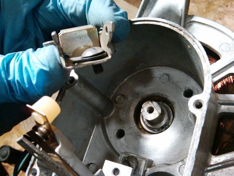

billmayo wrote:Yes, those 2 screws holding the end bearing needs to be removed plus the screw holding the centrifugal weight assembly to the end of the shaft. This screw is under the tip that pushes on the contact strip. This can be a very diffficult screw to remove as the weights are always in the way even when the springs are disconnected. I use an old trick for loosening this screw and retightening it. I use a nail center punch and set the point at the outter edge of the screw's flat blade screwdrive slot so when I tap the punch, it will slowly rotate the head of the screw.
I will be happy to respond to any questions and have some pictures available.
Bill,
Great instructions. I'm a confused on what the "screw holding the centrifugal weight assembly to the end of the shaft" is. "This screw is under the tip that pushes on the contact strip." I don't remember seeing anything under there. :confused:
I've identified several screws/parts on the following image to help us discuss this. Would you please point out where this screw is to which you are referring? It sounds like you are describing something at position #5 (under the strips). Do I need to remove screws identified as item #3 to just get the whole contact assembly out of the way?
Replacing the solder connection with a flat connector is intriguing. Do you plan to get into those motors frequently? :p

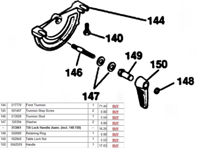

re trunnion......if your just trying to remove the trunnion from the stud, you turn the locking nut clockwise to tighten it so that you can file down the deformation made to the stud by the punch. Once it's cleaned up, you can remove the locking nut. Use protected pliers to turn the locking nut.
Mike, I am trying to remove the trunnion from the stud and also the stud from the tie bar casting. Should I not be trying to remove the stud also? On the back side of the casting, the stud is recessed about a quarter of an inch so I thought it could be punched out.
I made another photo to help us discuss this better. Are you referring to the lip on the collar around the stud (item #1) or the dimples/deformations I see in the end of the stud (item #3)? I think you are talking about #3 but I want to make sure because that collar keeps the nut from backing off entirely (with box end wrench). To get a file in there to file off the deformations in the end of the stud, the collar (#1) would need to be slipped back toward the nut, correct? It will turn a half revolution around the stud but I haven't tried to force it to slide on the stud.
[ATTACH]10946[/ATTACH]
The trunnion in the diagram on the SS website is different from my Goldie. This diagram shows the lock nut and the "collar" (item #1) to be the same thing. Plus, my stud doesn't employ a lock ring.
[ATTACH]10945[/ATTACH]

Maybe this helps??
mickyd wrote:re trunnion......if your just trying to remove the trunnion from the stud, you turn the locking nut (#1) clockwise to tighten it so that you can file down the deformation (#3) made to the stud by the punch. Once it's cleaned up, you can remove the locking nut (#1). Use protected pliers to turn the locking nut.(#1)
Text in red = numbers in your photo above.
You do know the collar with lip is threaded, correct? That's why you have to rotate it clockwise to allow the end of the stud to become visible so that you can file off the deformed threads on the stud. Otherwise, if you don't file the threads, you'll have to fight the collar with lip all the way off the stud since the threads are boogered up. Clear?? If not, shout. We sure can't blame any miscommunication on not having good pictures!!! :D If we're mis-communicating, I'll take the blame.

If you look at the center of the motor shaft between the middle of the 2 centrifugal weight springs, you will see a large straight slot screw that is difficult to see and to remove. This screw is directly under the tip that contacts and rides on the end of the contact strip. Yes, I remove the screw(s) holding the contact strip and bracket so I can get to this screw.
I switch from any soldered contact strip (older motors) to a newer flat connector contact strip as I needed to remove the whole end plate assembly for a modification I have been doing. I dig/remove the run windings and start winding ends from the run coils so I can attach new wire leads. I convert these motors to accept either 110 VAC or 220 VAC input power and/or make the motor reversible. I found that I cannot modify the Emerson motors this past week, only able to do some 3/4 HP motors and the 1 1/8 HP AO Smith and GE motors.

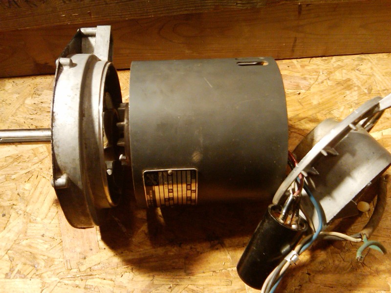

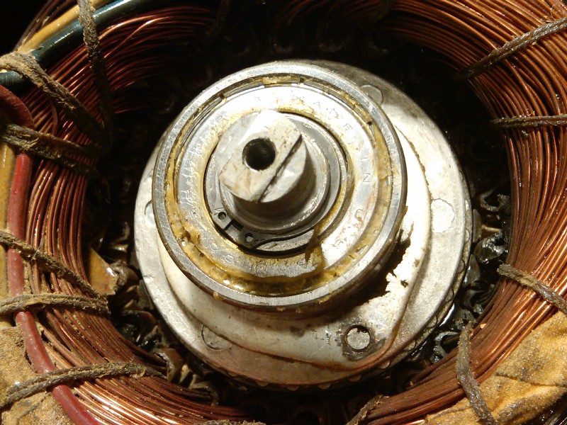

Thanks, Bill for the patience. After I got home I saw the glaringly obvious and rather large screw you were talking about at position #5. I removed the contacts assembly, the springs and the centrifugal weight by spreading the bracket ears apart. The screw was easy to get to then but I hope this wasn't a bad idea.

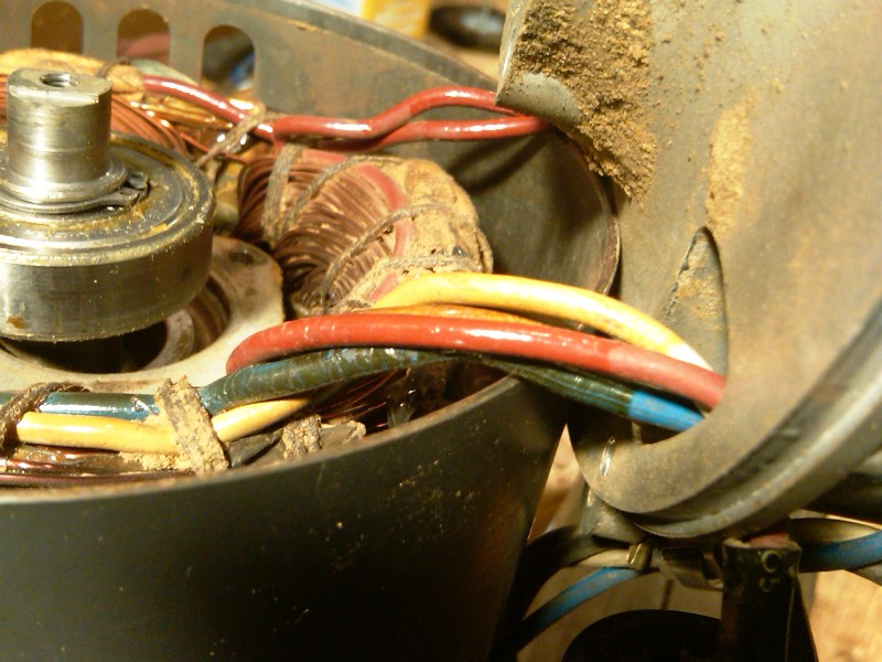

The motor is now disassembled. The motor bearings are stamped "Hoover 77203 Made in USA" and I did some research on the bearing. As described Bucksaw in this thread, the 3/4 hp motors use the 6203 bearings, which are extremely common. My research indicates that is the same bearing used in my AO Smith 1 1/8 hp motor as well. Apparently, the prefix '77' indicates the bearing is double shielded, which is what the 6203 bearings are. I suppose nomenclature has changed over time.
It appears the grease from the bearing on the "wire end" has pushed out and has hardened. The "fan end" bearing has some surface rust on the face and a red sheen around the sides. Not sure what that's from. I also read that in motors that have been sitting idle for long periods, the oil and base material in the bearings will separate. So it's definitely a good idea to change these bearings. I'm a little concerned about some cracking in the motor wires but it appears to be in the 'clear coat' as opposed to the rubber insulation.

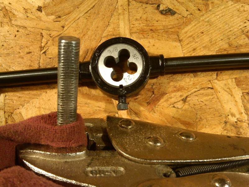

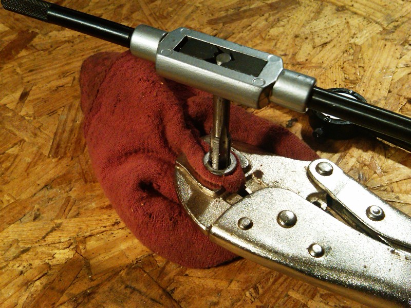

I was able to remove the stud. No, I'm still here - I was referring to the trunnion. [rim shot]
Thanks, Mike. You cleared that up perfectly. The nut and collar are two separate pieces but the collar is threaded. I used a rag and channel locks to screw it further onto the stud and then filed off the buggered threads as you said. I then backed it off with the rag and channel locks but still ended up marring the lip. Nothing a little filing didn't fix.
The stud is also screwed into the tie bar casting so I used an open end wrench and just backed it out. Then I used a micro file set to smooth out the big "punch deformations" (#3) inside the collar threads and on the stud. I then used a tap and die to clean up the threads on both components. The collar spins very freely now. I see why SS went to the snap ring set up they use now. There is enough space between the collar and the nut that I think I'll use a thin nut outside the collar and tighten the two of them together to keep the collar from vibrating loose instead of punching new indents. I don't know if that will interfere with the travel of the handle.
[ATTACH]10965[/ATTACH]
[ATTACH]10966[/ATTACH]
[ATTACH]10967[/ATTACH]
[ATTACH]10968[/ATTACH]
[ATTACH]10969[/ATTACH]
I'm now in the process of filing down dents, dings, and deformities in the trunnion gauge.
