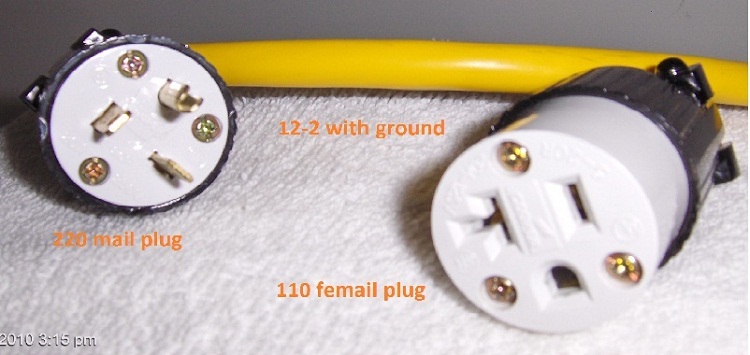

110 / 220 adapter cord
[ATTACH]10981[/ATTACH]
I assembled this adapter cord that allows me to plug my Power Pro into the cord and the cord into a 220 outlet. Works great. Got the parts from my local big blue box store.
- adapter cord.jpg (80.69 KiB) Viewed 4092 times

Kudos on selecting 20A devices. Actually 15A devices would have been adequate.ray1942 wrote:[ATTACH]10981[/ATTACH]
I assume you selected the 230v plug based on what receptacle you have installed in the shop.
Yes I did, I have a small basement shop with one 220 outlet.JPG40504 wrote:Kudos on selecting 20A devices. Actually 15A devices would have been adequate.
Not wanting to run another 220 line, I figured this was the easiest way to operate my "Power Pro" on either 110 or 220. Works great.
Ray1942
