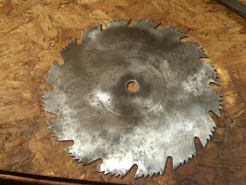

The cost of this project is a consideration so I'm trying to strike a balance with a little benefit-cost analysis, for you economists out there. I ran across a bottle of "The Must for Rust" by Krud Kutter at Wally World and thought I would give it a shot. I think I paid $4 for an 8 oz. bottle. Not the most economical, but fine for testing.

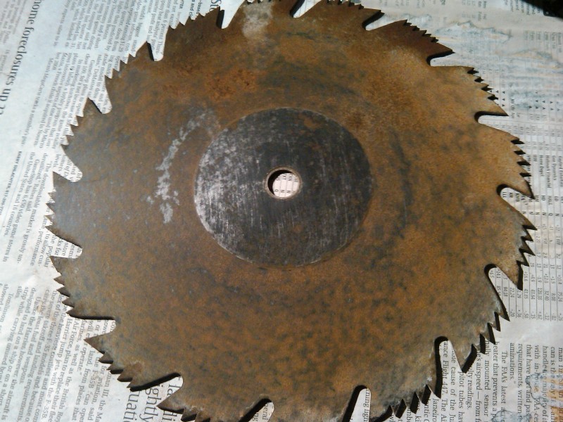

I started with the combination saw blade I got from my dad. It's in rough shape. Lots of rust, pitting and rust buildup. I didn't want to pour the stuff into a container large enough to submerge the blade because that would use up the whole bottle. So I squirted the stuff on the blade and used a chip brush to spread it around in what I thought was a fairly thick coat.
Here's the blade before treatment. The darker areas are caused by penetrating oil from removing the saw arbor.

As you can see, painting on rust remover isn't the most effective technique. At least not for this brand. Still, it has some effect. I'm sure a few more coats with the same process wouldn't hurt.

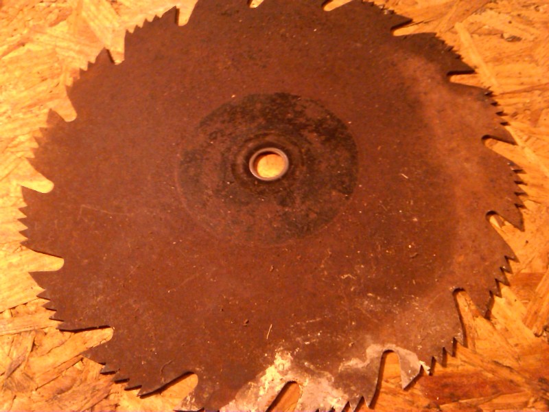

It's worth noting that the darker teeth at the top of the photo correspond with the teeth that DID NOT get soaked with penetrating oil to remove the saw arbor that the blade was stuck to. Moral of the story: penetrating oil will aid in rust removal.
Here's what the blade looks like after 15 minutes with a stout abrasive wheel on a drill motor. The darker area at the top is simply a function of sheen.
[ATTACH]10992[/ATTACH]
Moral of the story: need more cow bell... err... soaking with rust remover. See Test #2 for "the rrrrest of the story."

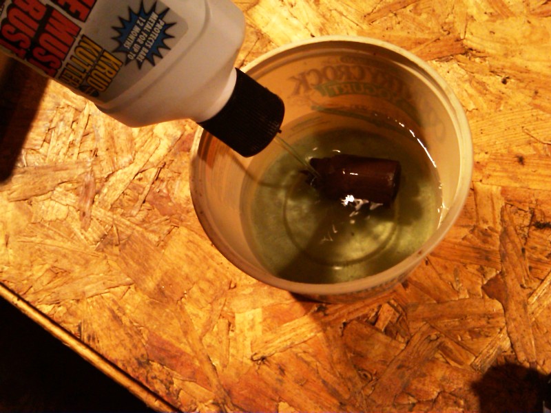

In this test, I submerged what I'm calling a lathe arbor to see how this works. I used the same "The Must for Rust" made by Krud Kutter that I got from Wal-Mart. This time, I used a solution of one part Krud Kutter to one part water. The label describes diluting with water, which is similar to directions on EvapoRust. Incidentally, this stuff is also supposed to be biodegradable (whatever that standard is) and is supposed to inhibit new rust for months.

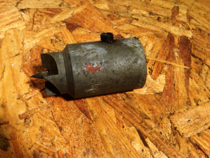

Here's what the lathe arbor looked like, pretreatment. Mmm Mmm...

Adding the Krud Kutter to the water at a ratio of +/- 1:1.
[ATTACH]10994[/ATTACH]
Right after pulling the lathe bit out of solution from its 24-hour soak. Man, that stuff smells like rotten eggs!
[ATTACH]10995[/ATTACH]

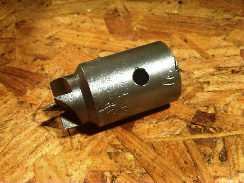

After hitting it with a steel wire wheel.
[ATTACH]10996[/ATTACH]

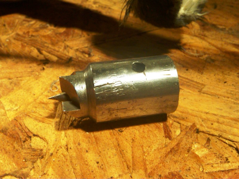

After a bit of filing and some white polishing compound (yup, I went to Harbor Freight today).
[ATTACH]10997[/ATTACH]
Despite the marring from Vise Grips or water pump pliers, it turned out pretty well. Moral of the story, soaking in "The Must for Rust" over night in a 1:1 water solution works pretty well and makes the stuff go farther. Plus, it removes rust deposits internally that abrasive wheels wouldn't be able to get at. The next step is to try Evapo-Rust and see how it performs.
