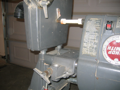

jimmyd: Here is the approach I used. This works fine for me. Good luck, John Mccrossen
https://forum.shopsmith.com/viewtopic.php?t=3019
http://www.shopsmith.net/forums/attachm ... 1233554191
Oops! I just noticed you referred to floating tables so you must be using a newer machine than my 500. Sorry.

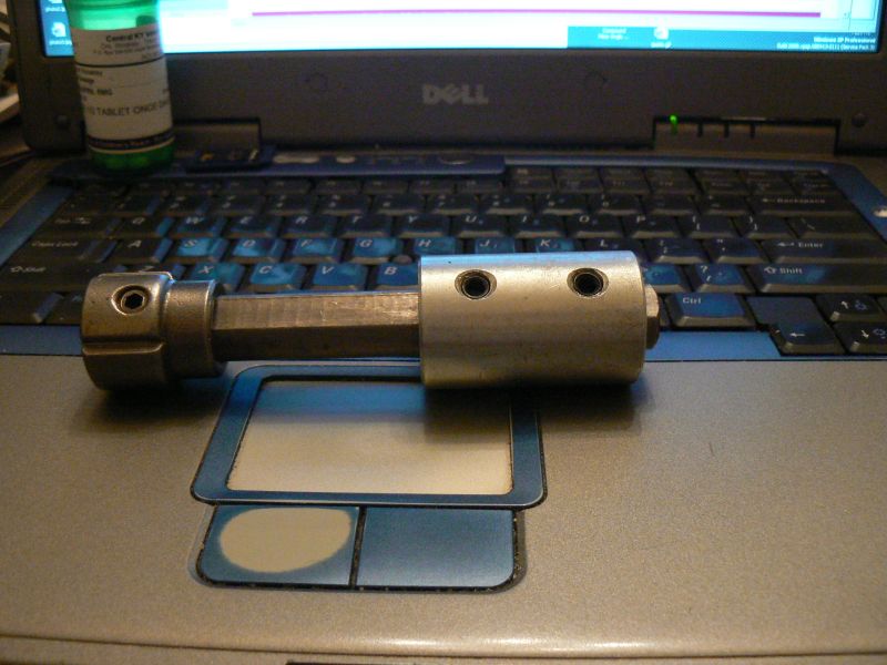

And then there be this variation. It allows removing the extension and coupler when not using the SPT. The steel coupler can slide along the shaft away from the headstock shaft to allow removal. The standard ss coupler is used on the hub shown.
[ATTACH]11068[/ATTACH]
The 5/8" 'shaft' is actually a mortise hold down bar!
- coupler extension.jpg (92.07 KiB) Viewed 2284 times

John, outstanding creativity! You're melding, what -three generations into one machine? There are some great ideas there.johnmccrossen wrote:jimmyd: Here is the approach I used. This works fine for me. Good luck, John Mccrossen
