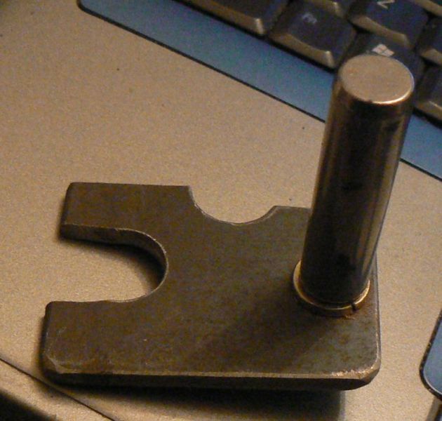

Floating sheave spring depression etc.
I use this 'tool' to depress the spring clip(newer variety).[ATTACH]11117[/ATTACH]
It is used in drill press mode. The shaft is inserted in the drill chuck and the notch on the end slips over the washer. The quill is used as a press to depress the washer and spring enough to allow removing the clip. The motor just sits on the table. The 'extra' notch in the side is left over from a previous task with that piece of steel.
