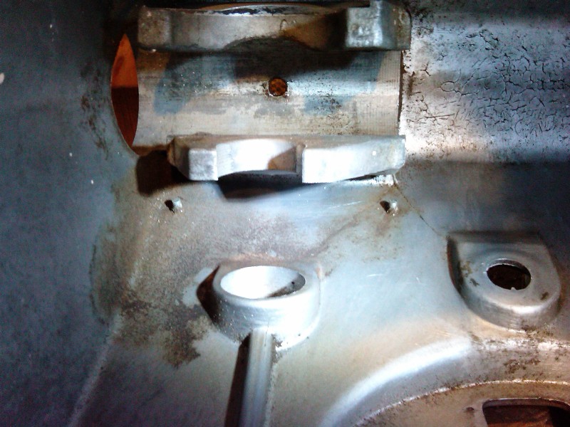

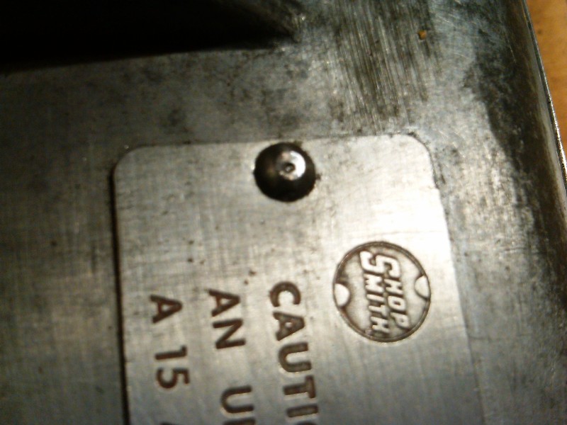

While most of the Goldie castings are in paint, I haven't painted the headstock yet. I'm debating whether or not to drill out the rivets in the caution plate to paint the headstock casting and clean up dents in the plate. My problem is multi-fold. First, is it worth it? Second, I'm not sure I can get new rivets in once the old ones are drilled out. How does one go about getting a riveting tool into this tight space? Lastly, these are threaded rivets, which I am not familiar with. Could someone explain how these things work?
[ATTACH]11139[/ATTACH]
[ATTACH]11140[/ATTACH]

Those threaded rivets in your link, is what's in your Goldie. I believe that it was Mickyd that was successful at tapping them out from the inside. I'll try and find the post where he explains the process.

They are pressed or knocked in and removed the same way. They are easily removed attacking them from the backside.
Here's how I got to the backside of my ER10 nameplate. Sky is the limit for your creativity.
Sunny San Diego

mickyd wrote:They are pressed or knocked in and removed the same way. They are easily removed attacking them from the backside.
Thanks, Mike. So basically these "U-Drive" rivets are self-tapping screws with something like two thread revolutions and no screw slot. I was concerned that just hammering them in would mar the round heads but apparently that's how they were installed. To drive these things out from the back would be near impossible because the sleeve for the quill is right behind them. I'll just drill them out and refasten with pan head bolts until I get new rivets in.

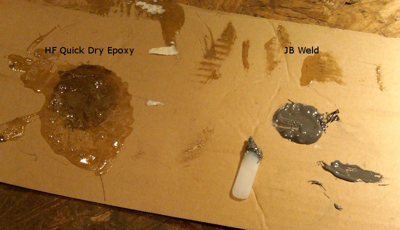

So I thought I would save a few bucks and buy Harbor Freight's knock off of JB Weld, or so I thought. After all, I'm repairing a casting defect that's non-structural. This stuff comes in two tubes of different colors and I thought would be a reasonable substitute. It is not JB Weld. Sure enough, it's epoxy all right. It's like thick super glue.
[ATTACH]11151[/ATTACH]
I ended up having to purchase the real thing so instead of saving a few bucks, I paid a few extra. So please, don't drink and dr... er... be excessively cheap. Funny how trying to be cheap costs you more money. This is a side-by-side comparison of the thick superglue and JB original.
[ATTACH]11152[/ATTACH]

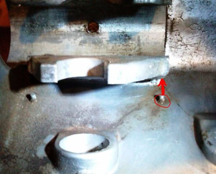

ddvann79 wrote:Thanks, Mike. So basically these "U-Drive" rivets are self-tapping screws with something like two thread revolutions and no screw slot. I was concerned that just hammering them in would mar the round heads but apparently that's how they were installed. To drive these things out from the back would be near impossible because the sleeve for the quill is right behind them. I'll just drill them out and refasten with pan head bolts until I get new rivets in.
[ATTACH]11150[/ATTACH]
You could consider the U-Drive as a self tapper but if you REALLY trying to impress someone with your schmarts, you'd categorize them as "Metallic Drive Screws". That's what they are. :D .
These things are made of hardened steel and you won't be able to drill them out. Just take a file to the head and you'll see. You'll should try to get them started from the back. It doesn't take much force. I understand the tight quarters your in but from what I see in your pics, you can do it. See the attached pdf for what I mean. Very gentle taps will get them to move. DO NOT BREAK THE CASTING EARS. Once they move, you can easily grab the heads with pliers.
[ATTACH]11153[/ATTACH]
Your other option is to GRIND. Grind a slot in the head and turn with a screwdriver.

Thanks, Mike! I hope you didn't draw up that illustration just for me! That's exactly the kind of thing someone as dense as me needs.
Mike, I think Magna may have used "metalic drive screws" of differing hardness between the 10er and Mark 5. The rivets in my headstock were definitely steel but they were soft. I got out to the shop last night and proceeded to drill them out before I read your post. :o
I used a medium file and put a flat surface in the top, then made a center punch with a dimple. I used a relatively inexpensive Black and Decker metal bit and WD-40 to drill them out with great success. Once drilled, I knocked off the back of the rivet with a cold chisel. BUT if I had used your method, I may have been able to reuse the rivets! :rolleyes:
