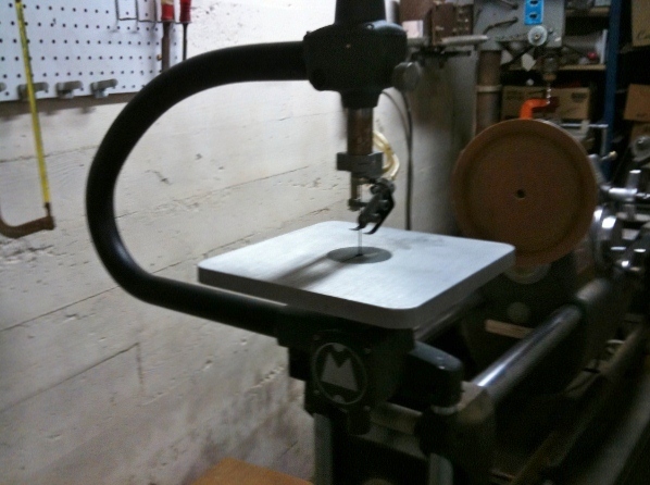

Came across a (new) still in the box Magna Jigsaw awhile ago, Dont know much about it and I think it needs oil in it before running? Lost the tag on what kind of oil?
Anyone know anything about this unit?
Appreciate the input thanks

Most everyone on here, including myself use air compressor oil.
Like to see a photo of a new in box unit if it's not too much trouble.

Thanks Cincy just figured that out

May not be a problem for you because it's never been used but the gasket under the front cover often leak. I made a new one from gasket material from the auto parts store.
Does the NIB unit have an owners manual? If so it would be great if it could be scanned and posted. The one floating around on the net looks to have been copied many times and kinda hard to read.
