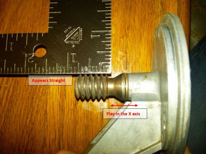

The shaft appears straight to me, although it could still be out of round and not be discernible to the eye. When rotated, the rule doesn't feel like it lifts anywhere along the threads. However, I'm a bit concerned now that there is too much play in the shaft seat. Should it move a little, in and out of the speed control?

ddvann79 wrote:The shaft appears straight to me, although it could still be out of round and not be discernible to the eye. When rotated, the rule doesn't feel like it lifts anywhere along the threads. However, I'm a bit concerned now that there is too much play in the shaft seat. Should it move a little, in and out of the speed control?
Bill, I'm definitely interested in your bolt replacement fix.
[ATTACH]11195[/ATTACH]
If that pix shows the total extent of the end play, I would not be concerned!:cool:

Yes, that is about as much play as the shaft has - maybe a hair more. I was thinking that the play would have the benefit of relieving some of the bite that develops at the end of the ranges of a rack and pinion system. On the other hand, the thought occurred to me the gap may also allow they worm to cause excessive wear in the soft aluminum if alignment were to get off.
I use to have a 1984 1/2 ton Dodge 4x4, with a 360. My baby. Anyway, I was headed down a gully a little fast one time and I hit the bottom with the front right wheel first - hard. It caused the rack and pinion steering to jump one tooth to the left. I couldn't turn as far to the right after that but I could turn farther to the left. I was lazy about getting it fixed and a year later when I got around to it, I found the rack to be worn excessively at the left end of the range that looked somewhat similar to the wear I see here. Of course, it the wear marks werelongitudinal instead of conical since the SS has a http://upload.wikimedia.org/wikipedia/commons/9/98/Schneckengetriebe02.jpg[/img]]worm shaft as opposed to a pinion gear.
All the same, could it be that the extra play in the worm shaft would create the opportunity for excessive wear? As relatively simple as they are, the geometry of a rack and pinion has to be dead on. Has anyone tightened up the worm shaft so it doesn't move as much.

I had some play in mine about a year ago during a rebuild. It was caused by the snap ring that holds the worm gear in position had risen up the shaft toward the control handle. There should be a wavy spring washer on the shaft under the snap ring. I think that this occurs from someone forcing the speed control handle without the machine running. You can seat the snap ring by using a 1/4" drive deep socket to push the snap ring down until it seats in the groove.

Shaft end play: This will cause the control dial to have backlash, and result in the indicator ring having slop as well. Not a serious dilemma! It will not cause abnormal wear of the teeth.
The beveled gear on the quadrant is not shaped like a true driven worm gear. The root and top of the teeth are flat(not curved to match the radius of the worm gear). This results in the mating surfaces being line contact. As a result of the minimal area, any displacement of the leg will cause the worm gear to wear(cold flow) the softer quadrant gear material.
The wear after the leg is bent, will not be in the same location on the quadrant gear as the line of contact when the meshing is 'normal'.
For that reason the removal(filing down) of the displaced material that is causing jamming in the abnormal mesh position will not be doing the same after the normal meshing is reobtained.
Wait and do the filing when you ascertain there is an interference with normal meshing.
