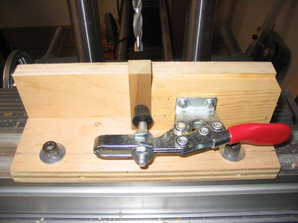

Try a variant of this fixture
[ATTACH]11216[/ATTACH]
I made this for a 520 fence but it can be modified for just about any machine.

- drilling fixture.jpg (39.95 KiB) Viewed 7506 times

I built a jig similar to the one here
http://www.shopsmith.net/forums/attachm ... 1245373528
I first did something like this one:
http://www.shopsmith.net/forums/showpos ... stcount=28
Both do a good job. The one on top is easier to use; the one on the bottom is easier to align square to your drill bit.
