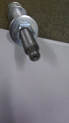

The photos of the ends are a little blurry, but the threaded end now has a 1/2inch turned section that can be mounted in the SS 1/2inch drill chuck, of the 1/2 inch router bit chuck.
Both ends have indents. I used a 60degree live center in the tail stock, placed in to the indent on the shaft's #2MT end.
What I liked best about this modification is that no modifications to the Beall shaft were required. Should I ever want to use this on another power source, it's ready to go.
