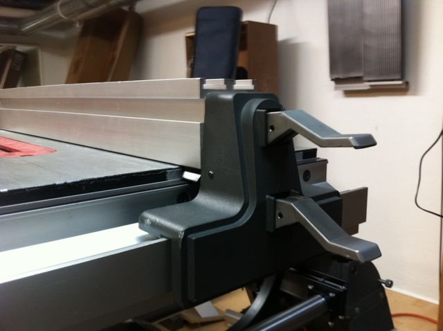

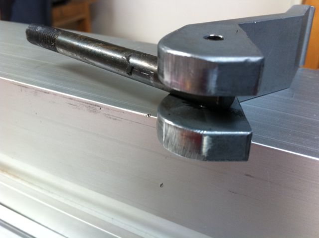

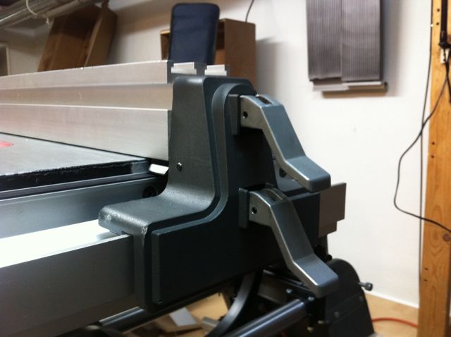

I attached 3 photos. The first is the lock position before the modification, the second is after. The third photo may be a bit hard to see, but the shiny area is the spot that was ground down. It's not a flat grind - I rotated the cam while touching the disc so it follows the curve and just shaved off the high spot (it didn't take much).
If your levers easily move to the fully locked position, then they are fine. If you need to press hard to get them to lock, then perhaps you need to make the modification.
