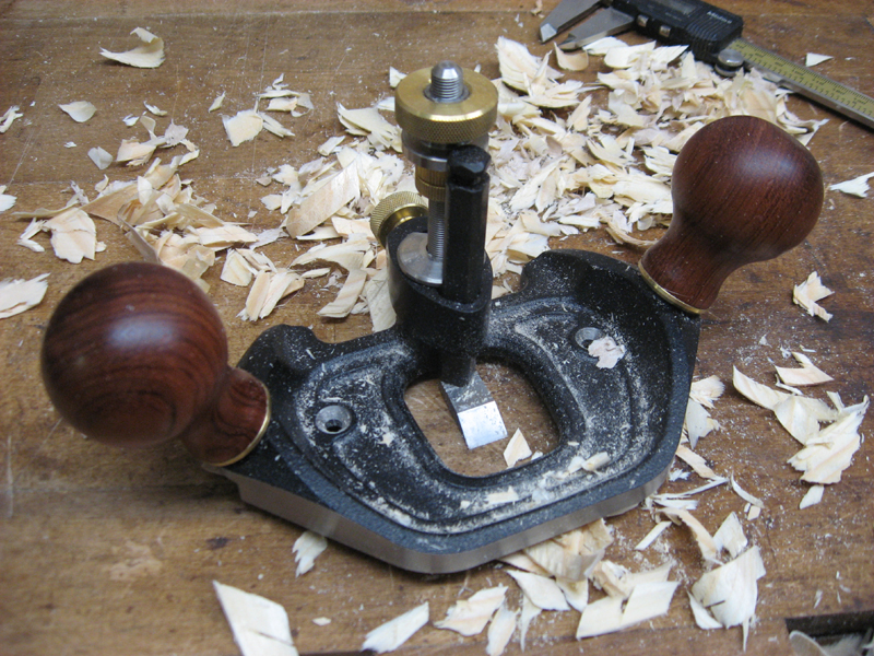

horologist
Posts: 431
Joined: Sat Dec 22, 2007 6:36 pm
Location: Melrose, FL
Post by horologist »
At the risk of being classified as a troublemaker.
There is an alternative.....
:D
[ATTACH]11340[/ATTACH]
