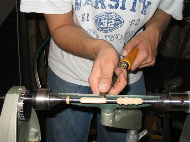

shopsmith toolrest
in this pic you can see the shopsmith toolrest.
- IMG_7028 (Small).JPG (48.16 KiB) Viewed 5339 times
