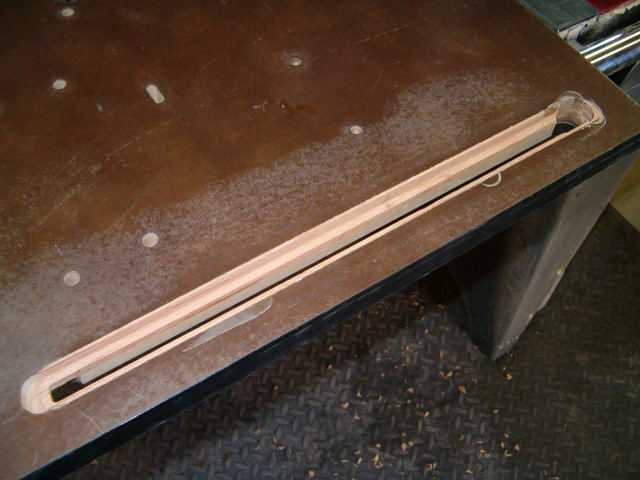

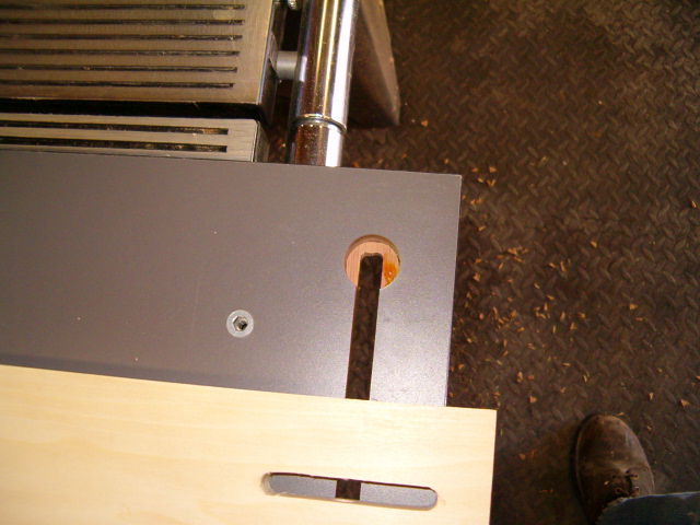

Yep! I did that by mistake - I looked at the blackboard drawing and drew it out on my CAD program by memory. Shouldn't have done that! Took the drawing into the shop and proceeded to drill and cut the slots on the Overhead router.fjimp wrote:Hey Chuck I am curious do you have all 4 of the 1" slots end holes drilled all the way thru the table.? If so how well does that work? Jim
Here is my fix , which also fixed another concern I had at the same time. In my thinking, I also had to fix the soft underside of the slots (MDF I think). I felt if the shoulder bolts get twisted they will eventually wear out the bottom of the slots. Also I quickly:rolleyes: (after trying it out) realized sometimes the bolts should be closer to the inside edge of the table. With the holes there - there was no grab Duhh!:( So to fix both issues - I made the counter-bore parts of the slots 3/8" or so deeper. Then lined the counter-bores with oak. Then did thru routing again of the slots - including through the misplaced holes. Since the bolts hold real good without filling the tops of the holes I see no need to plug the holes and then route slots through the fillers. Took several pix earlier when warning of the mistake. Here's two of them.
[ATTACH]639[/ATTACH]
[ATTACH]640[/ATTACH]
- bottom counter bore.jpg (126.03 KiB) Viewed 24123 times
- HPIM1514.jpg (120.39 KiB) Viewed 24135 times
